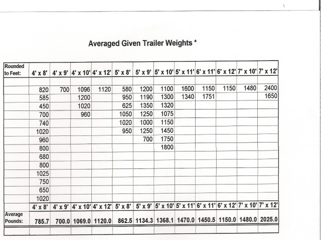

Postby halfdome, Danny » Tue Feb 05, 2013 6:21 pm
Wasn't too hard to find since it was discussed just recently.

Postby 55chevy » Thu Feb 07, 2013 6:39 pm
halfdome, Danny wrote:Image
:D Danny
Danny: thanks for that last post, I couldn't find the averages you mentioned earlier.
Also, Thanks to all who posted their weights and comments. I feel pretty good with my estimate to build a Benroy 5x10 for in the 1100 to 1400 lb range. I order my Dexter #9 today and requested a tune of 1800. :frightened:

Postby halfdome, Danny » Thu Feb 07, 2013 9:53 pm
55chevy wrote:Danny: thanks for that last post, I couldn't find the averages you mentioned earlier.
Steve
This chart was made by Anjib :thumbsup: .

Postby S. Heisley » Fri Feb 08, 2013 1:07 am
Gee Whiz! This weight thread was so close to that last one that I thought you weren't happy with the information that I provided and were looking for only those that had been put on scales or something else. I didn't know you were looking for my chart! Sorry about that.
As you probably know, the chart was compiled in November of 2009 and that was before foamies where being made; so, it does not include information on foamie builds. When I posted it recently, I left off some of the background as the scanner wouldn't pick it up. For the record and so you have it all, in case you want to verify it, here is where the data is that I compiled the information from:
* Averages are based on information taken at 12:31 PM PST on 11/21/09 from two threads:
User Poll Thread: What does your teardrop weight?
General Discussion: Whats the size and weight of your teardrop
* The content of this chart is subject to human error; however, please be aware that:
- If someone was kind enough to answer both threads, effort was made to eliminate duplicates.
- If size was not given, that weight could not be used.
- If inches were given, they were dropped/rounded to feet.
- If more than one weight was given, the highest weight was used.
- If a category has only one entry, that will be its "average".
