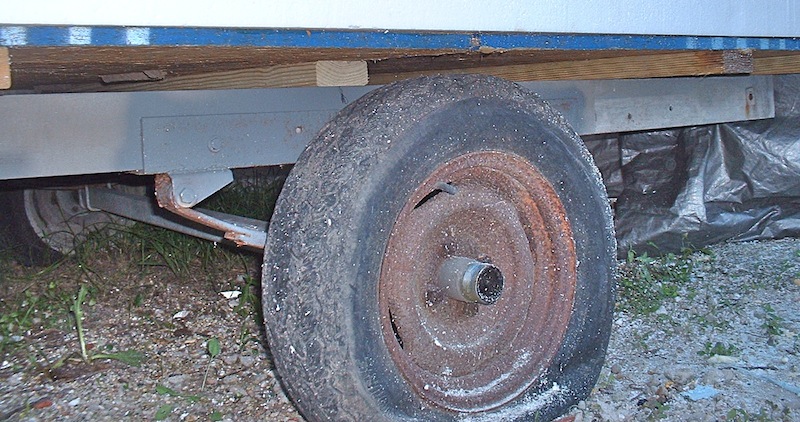

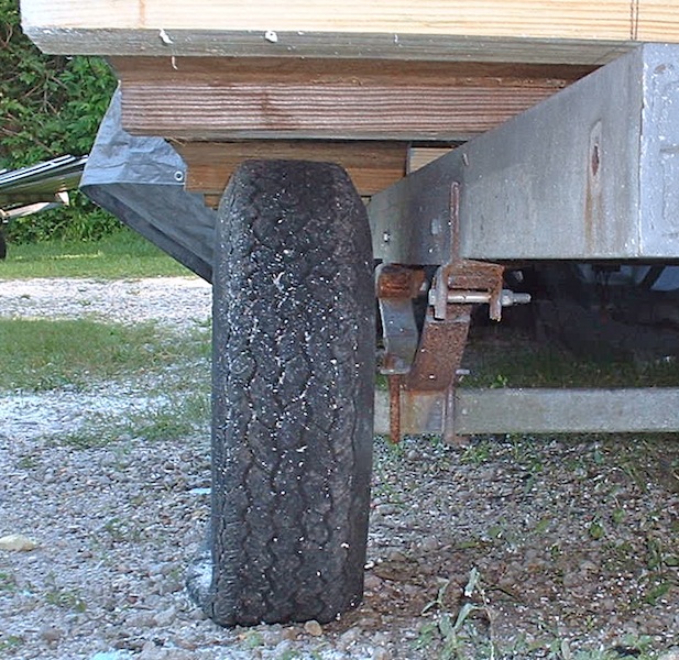

Postby GPW » Fri Jul 12, 2013 11:01 am
My springs are already above the axle ... here’s a pic of the current set up ... with 13” tires (or what’s left of them) .... going to the 12” tires should give me a little extra room eh ...? :thinking:
Those nasty old springs really need to be replaced anyway ... or at least cleaned and painted ... :oops:
Re: Raising the trailer height ...
Postby desertmoose » Fri Jul 12, 2013 11:17 am
Hard to tell from the pictures, but it looks like the springs are mounted to an angle that is bolted to the frame. If so, could you put a spacer between the frame and angle? That would give some more clearance.

I see 2 bolts arraching the hanger frame to the trailer frame. Unless it is welded to the trailer frame, I would drill two holes higher on the hanger frame (to match the trailer frame), slip in an appropriate sized thickness of flat bar or square tube between the trailer frame and hanger frame, tack weld that spacer in place, slip the bolts thru the new hanger frame holes.
