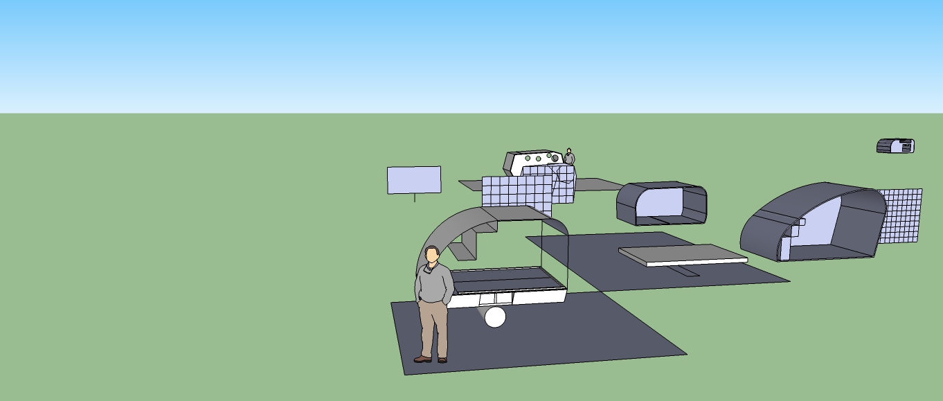

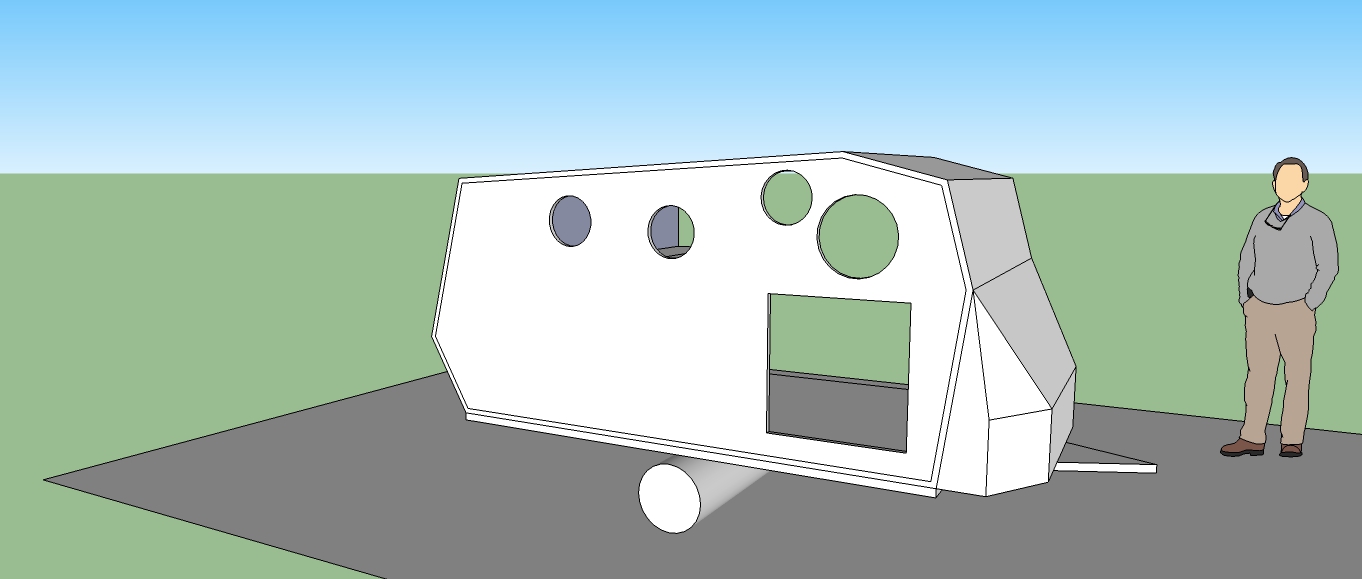

Postby NavySeabee6969 » Fri Apr 18, 2014 3:22 pm
Wow!! Thank you for all the input. I greatly appreciate it. I do feel Rob has the nail hit by saying the house is only as good as the foundation. I will definitely go the locally procured route, I have to support the local business around Mississippi. I would have loved to see Steve_Cox's TD in person. The woodie TD are so neat and original. AS for now, I am still on the search for inspiration and design ideas, I have done a tone of SketchUp design ideas and have narrowed it down to either a traditional TD body, or a TD body with just angled corners. I also want to include a possible rook rack system, and definitely some solar panels so the wifey and I can go 'off-the-grid' for a weekend. Still in S. Korea at the moment, but I should be heading stateside by mid-summer. But dont worry, I will document every step I take and post the build process with every purchase and build day. Thank you for all your input and support, and I hope to see you at a campsite soon!!
V/R,
Kevin
Ive been pretty busy and bored
trailer-camper idea4.jpg (148.19 KiB) Viewed 1815 times
ANother angle
trailer-camper idea2.jpg (149.75 KiB) Viewed 1815 times
My potential final-ish design
trailer-camper idea1.jpg (182.61 KiB) Viewed 1815 times
NavySeabee6969
Posts: 4
Joined: Mon Apr 07, 2014 3:18 pm

Postby DMcCam » Sun Apr 20, 2014 2:56 pm
Hi Kevin,
We had our chassis custom built locally and the cost was reasonable. You can check out my plans and thread below if you're interested.
What size are you planning on building? Your design is pretty cool. My only concern is with size of the doors. You might consider making them taller something around 38" (if they're not already). It makes it much easier to get in and out of.
Cheers,
Dave

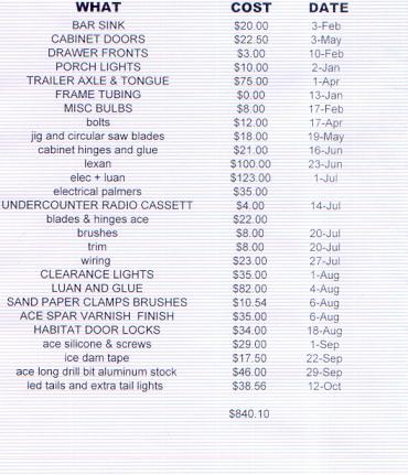

Postby bobhenry » Fri May 30, 2014 5:41 am
A mashed up HF frame off of E Bay and less than $900.00 and I went campin'
The lumber was free from work and a lot of the scrap , crap, and toys I had acquired in my hording days so there was really very little outlay of cash.
