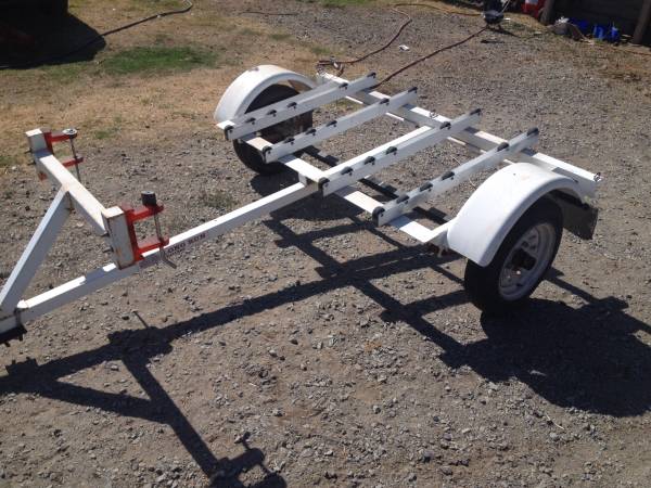

My next question is if I plan to extend the tongue by 1 ft. how much of the original tongue should the sleeve cover on both ends? Should I use all 4 ft.? Meaning it would cover 1.5 ft. on both ends with a gap of 1 ft. between. Is there a minimum length of insert?
Below is the trailer I am planning on doing this to.

That receiver tube looks beefy. Maybe too beefy for your light weight goal.
I think it depends on how much of the tongue will extend past the front of your cabin, and how the rear of the reinforcing is tied into the floor.
Have you looked at Angib's tongue strength link from the Design Library under the Resources tab, above.
Also have a look at his Ultra Light design that I mentioned in your other thread. This would be a good way to strengthen your extended tongue while also adding some tie in for the front part of your floor.
The temptation may be to add a big old honking piece of steel to strengthen and reuse the existing piece, but that will add weight that is perhaps less efficient than just changing the piece out, or going to the ultra light style A-frame and killing two birds with one effort. The fab work, material cost, and welding effort are all pretty much the same at this point in the game, so I would look closer at the big picture and not just at a patch job.
$.02 as requested. :thumbsup:
