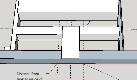

I am in the process of getting someone to build my trailer for me. They build their frames out of 75mmx50mmx3mm SHS with the cross beams being 50mmx25mmx2mm SHS. Asked about C channel and they only have it in big pieces and he said the 3mm angle would weigh almost as much as the stuff. Only the bloke that builds trailers in town booked out till April. My estimate is that the trailer frame should with 83-85 kg without any axle or wheels. My design is below.

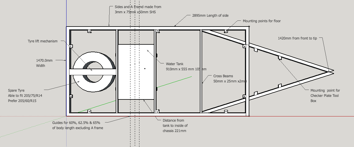

As you can see I am planning on the spare tyre being under the back and a 45 litre water tank just under the axle line .
Now for the hard part. I understand nothing about axles and the distances required for clearance etc. I know my problem is the water tank. I don't want the axle coming up and hitting the tank so I think that rules springs out, unless the axle is hung under the spring instead of on top. It is not a 4WD unit so I want it to be sleeeeeek. So I think that rules springs out.
Therefore I believe I need a torsion axle but I am not sure if there is enough clearance for one of those even. What I did find was Flexiride half-axles, but I am not sure about them either. I am hoping to bring the build in around 400 Kg but still doing some maths there. Intending to cover it in fibreglass sheeting that doesn't weigh as mush as aluminium.

So to fit it all in I need a breather hose connection on top of the tank (30mm) the tank itself (105mm) and finally the straps holding the tank up (5mm), giving me a grand total of 140mm. That means it hangs 65mm below the side frame.
You can see on the diagram I have marked the 60%, 62.5% and 65% of the body length marks across the trailer. The centre of the water tank is about 61.75%.
What advice do you have for me. Thanks

I have seen the black plastic huntsman ones. They have a depth of 170mm. I have also seen similar ones at 180mm. That will add 70-75mm to the depth. If I can get away with it using this design I will jump at it. Tank is less than half the price and you can carry twice the water.
There is the option of putting the tank hard up against the floor and losing the breather on the top having to punch a hole near the top edge. Would lose a bit of water but might work.
Still don't want the trailer to ride too high.

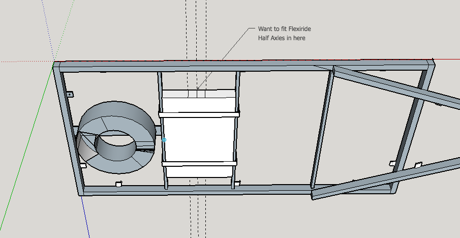

The half axles look like they bolt onto a plate. If the plate was welded to the frame and to another piece of metal going between the two cross members would that stop twisting. You could even use the same size steel as the side frame for the cross members near the tank.

IMO, the extra cost of the individual axle halves provides only a small advantage of ground clearance, since compared to a full torsion axle the xmbr can be mounted flush with the frame. If you are not planning for rough conditions that isn't really a factor for you. So assuming you go with a full torsion axle, maybe the thing to do would be to mount the tank just ahead of the axle. Keeping the tank close to the axle would still help minimize the effect of variable ballast, but would solve your packaging issues.

This is a quick picture of what I was trying to describe
Screen Shot 2014-10-29 at 11.20.17 pm.png (15.13 KiB) Viewed 1305 times
You would then bolt the half axle to the plate
Strop

If I move the tank forward I can use a sprung axle I don't need the torsion one. Cheaper too, but I lose that balance. As shown the water will have almost no impact on balance of the trailer as it is positioned straight over the axle.
The question is if I go that route of putting the tank right at the back and the spare tyre further forward how will it impact on balance and tongue weight. Or do I ditch the spare all together? Just carry a can of goo around to pump into the tyres in case of a flat.

Postby KCStudly » Wed Oct 29, 2014 12:22 pm
Carrying a spare is a better idea because it can cover a lot more scenarios than just a minor puncture (blow out, lost tread, busted belt/bulging, heavy gouge, lost valve stem, etc.)
Thanks for the picture, that makes it much more clear what you are proposing, and IMO is a great solution, other than the extra weight and cost of the axle units.
I guess it comes down to your design goals. 45 liters is about 12 gallons which will weigh about 100 lbs. Shifting 100 lbs forward by half the distance of the width of your proposed tank (so that it sits just ahead of the axle) will shift about 11.6 lbs onto your tongue; maybe 1/ct of your final over the road weight. Put one CI DO in your galley and it cancels that out. Drink all the water and you are back to square one.
But if your TV is very sensitive to hitch weight, and you really want the tank dead on the axle, what you have drawn there looks good to me. :thumbsup:

Thinking about it some more, and maybe something you hinted at, with the torsion axle the cross piece actually is further forward than the center of the axle hubs, so the tank would have to be shifted further forward, or the tank and tire locations could be swapped with the tank nestled closer to, but behind the actual spindle pivot point. Putting the tire in front of the axle might actually balance out the offset of the tank. :thinking: ... but it would make it a little more difficult to get to the spare if needed(?). :thinking:
