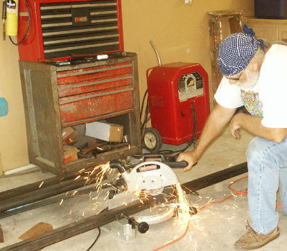

Postby madjack » Mon Jan 23, 2006 5:55 pm
Dale, we bought one of these from HF...caught it on sale for 50 bucks...course we had to spend 20bucks on blades for it

Postby Steve_Cox » Mon Jan 23, 2006 5:58 pm
I got my 10" metal cutting disk for my miter saw from McMaster.com. Just because I didn't have to leave town to get it. Just be sure to remove any plastic parts from the saw that the sparks from the steel will come close to. They melt and burn pretty easily. Other than that the miter saw made really close tolerance cuts.

Postby weasel » Mon Jan 23, 2006 6:36 pm
The ''metal'' chop saw I used has the miter gauge. We mitered the corners on the frame, cut the axle and angle for mountin' tabs. When on sale $50 at HF.

Postby Steve_Cox » Mon Jan 23, 2006 9:03 pm
powderburn wrote: Steve....What is the RPM rated at?....Ive always wondered if using an abrasive disk in a miter saw would work.Is that blade a special design as compare to others?
10"X1/8"X5/8" arbor FLEXOVIT brand fast cut Metal, Stainless. Rated at 6112 RPM. My Craftsman 10" Miter saw is 5000 RPM no load speed. It was the cheap one at McMaster.com. not too special as I recall....

Postby Sonetpro » Mon Jan 23, 2006 9:04 pm
PB I think if you exceeded the rpm's you run the risk of the wheel breaking apart. I've had a angle grinder cutoff wheel do that. :O I use a porta-band for fine cuts.

Postby Chuck Craven » Mon Jan 23, 2006 9:14 pm
I would not cut steel in a power miter box, as it is not built for that job.
Most power miter boxes are made of cast aluminum and will break form the stress.
Look at your manual that came with the saw, it should say do not cut steel with this saw! :cry:
