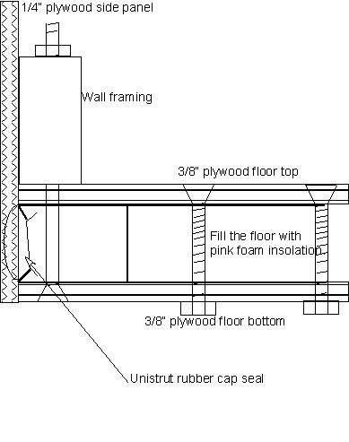

Do we need to weld? What kind of bolts?
Advice or information would be greatly appreciated.

Chuck Craven wrote: The tongue is the only problem that I can see. But a square tube like 2 x 3 with a 3/16 wall should work for that. Maybe run that under the superstrut but weld angle tabs to this for bolting it to the struts. Don’t drill through the tongue except for mounting the hitch coupler!
Chuck Craven wrote:Well the U bolts would stick up in the floor! If the U bolts came loose you will have a tongue but no trailer.
