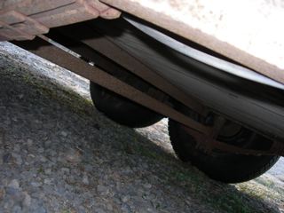

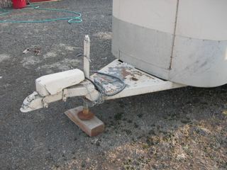

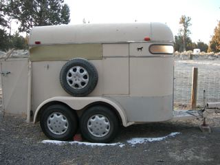

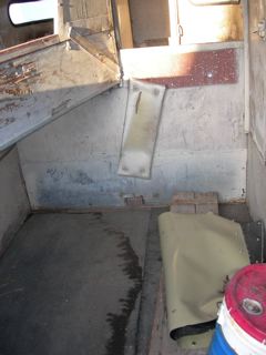

So, we have this horse trailer that we got a couple years ago for about $900. It has outlived the horse and we are only using it to store our precious collection of three empty buckets. I suspect that it's a pretty beefy frame.
The tires are almost new and it tows fine. I'm wondering if I can remove one of the axles and remove some or all of the rest to make room for the TD.
The trailer is a 5x8, I think. Inside width is about 58".
What do you all think?

That trailer frame has got to be big enough for what you want, though it is sure to be a lot more heavily-built, and heavy, than you need or want - but that's likely to be no more than a 100lb penalty or so.
I don't doubt you're right to think about removing one axle. The existing leaf-sprung axles will have the adjacent ends of the leafs on each side meet on an equaliser that (wait for it...) equalises the load on the two axles. A single axle can't use this equaliser and will need a separate mount. This illustration from a Dexter catalogue shows the idea:
This is not a problem, as leaf spring axle components are largely standard. It does mean you'll probably need a little bit of welding to fit the new mount, but then you'll need a bit of welding anyway to reposition the axle.
Those tall wheels mean that you'd be a bit limited about what you can do in the way of a layout - you'd either have to stick with the 5' body width or plan to have something quite high over the wheel wells. For example, if you put a transverse dinette at the back (simple, gives seating) it would have to be raised quite high to get the seats above the wheels. This would give yu something quite like the Lemon Drop.
Just a thought - why not keep most of the existing body? They're a lovely shape, as aerodynamic as could be and someone else has already built it for you. It might take a bit of re-skinning here and there, fitting a door to the rear, adding some windows and a splash of paint, but it's all there. I'm even getting an idea for a fold down canvas extension on the back - I cant see a ramp, but presumably you have one.
OK, you'll get treated like the poverty relations for living in a horse trailer (but then you could really let your standards slip delightfully....) and you might have to do a bit of cleaning to rid the trailer of any current, ahem, odour.....

First thought is...SELL IT...you can do a bare trailer frame for a TD on the cheap side around 250/400 bucks and on the top end for 6oo or so
Second thought is...USE IT...leave the body as is and convert the whole thing into a TTT(same caveats that Andrew gave)
Third thought is...convert it...this would be my choice of no other choices available choice..you would haveta remove both axles, and remount one more or less centered where the two used to sit...junking the body, probably the floor...way more beef in frame than needed...don't forget to check those old bearings, lights, wire, etc...is it worth all of that...only you can answer that one

Is it only me?...and not to suggest some sort of copyright infringement, but I see a Camp Inn "Raindrop" knockoff in that nag wagon. I really, really like what Cary did with the Model 560. http://www.tinycamper.com
