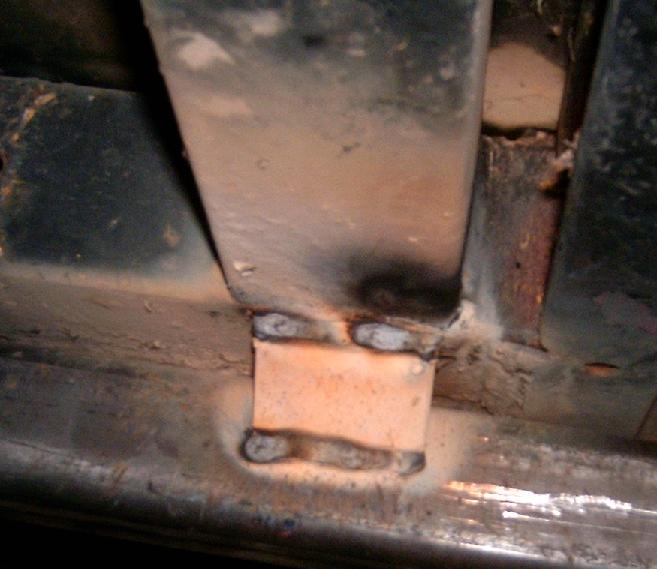

Postby starleen2 » Tue Aug 07, 2007 9:30 pm
Tractor Supply Co Model SKU #1000215 GVWR- 1500 lbs Tip: the trailer tongue mounts to the trailer at only two points with hardened bolts. When I built my camper using this trailer, it became oblivious that these two bolts were the only things holding the tongue bar to the trailer assembly. I guess this was a design feature to allow for a tilt bed feature. Upon the completion of the camper and the first trial run, I noticed that there was considerable movement between the two bolts and pivoting within the joint. The 2X2 angle iron on the frame was also flexing. Every movement of the camper made the two joints jump and pivot like a see-saw. To remedy this, I welded the points were the bolts passed through the tongue and angle iron connections. BE SURE TO REMOVER THE TRAILER WIRING HARNESS FROM THE TUBING BEFORE WELDING! This eliminated the problem.

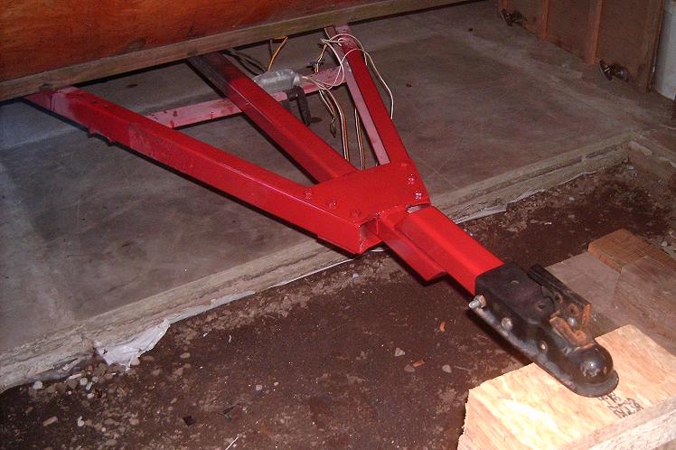

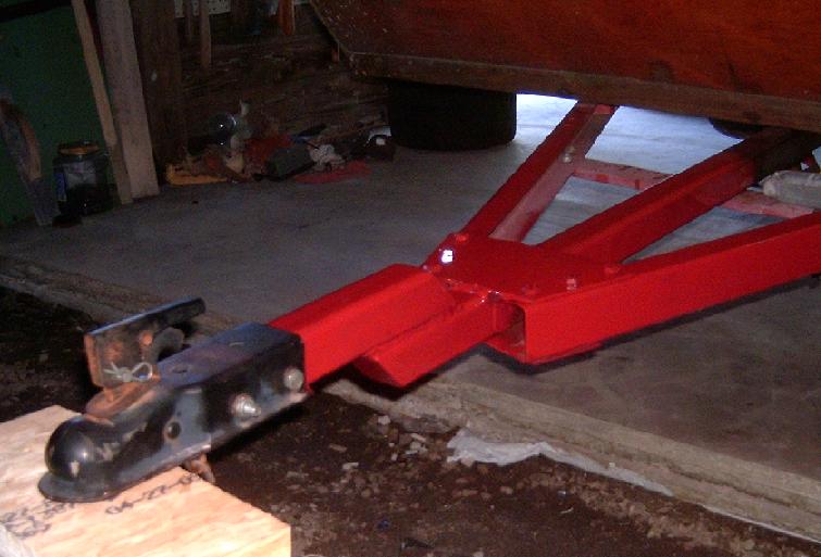

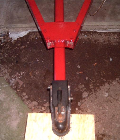

Postby bobhenry » Wed Sep 22, 2010 12:46 am
Which ever one do yourself a big favor and reinforce the tongue with a 2x2 x 1/4 square tube.
I would advise taking it all the way to the rear. I know , I know it adds weight. Setting on the side of the road with a failed tongue is no fun either.
adding 15 to 18 inches to the length significantly improves road manners and makes backing a great deal easier.
