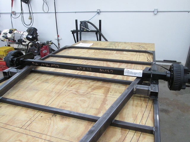

Postby alaska teardrop » Mon Dec 31, 2012 6:56 pm

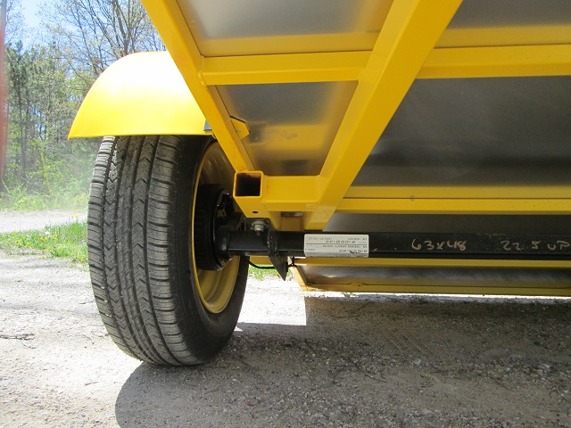

    Dexter #8 - 1100# - 22 1/2* up start angle
    Dexter #8 axle w/7" brakes
    Adjustable forward or back for final balance before fender installation
    195/70/14 Radial tires
    Steel wheels w/moons
    Edit:
    Weights: Frame & floor steel = 83#, Axle w/brakes = 82#, 2 Steel wheels/tires/caps = 70#, Jack w/o wheel = 7#, Chain/links/bolts & nuts/coupler = 7#
    Total chassis weight = 249#.
    :peace: Fred

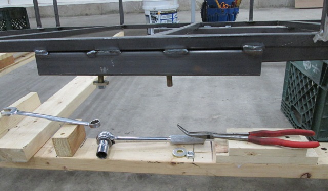

Could you answer a question for me please? For your adjustable axle mount, how do you get the bolts in (and have room for a wrench)?

    To answer your question, this picture probably shows the axle attachment the best.
    The tubing is 2" & the bolts are 1-1/4". After the cabin is finished the axle is lifted in place. The bolts are dropped in place through the open ends of the tube with a long nose plier. The head of the bolt is held with a box wrench while the heavy washer & locking nut are secured with a socket wrench.

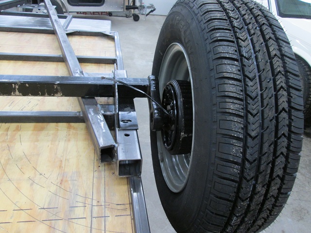

Postby KCStudly » Thu Jan 24, 2013 7:34 pm
Not exactly on topic, but interesting just the same: the trailer hitch kit that I got for my Ford Escape TV (with unit body) included a fine spring wire fish tool that had a cork screw like curl (a spiral wound end that gripped the treads of the bolts) on one end that was used to pull the bolts up through the channel in the unit body frame rail and out through the existing holes. I don't recall at the moment what kept the bolts from turning while securing the nuts, but it worked very well.

the hitch for my '12 focus (same car underneath now) went on the same way, before you threaded the bolt onto the helicoil looking end of the wire you put the wire through the square hole in rectangular plate, this kept the bolt from turning, (this works better if the hole you drilled in the frame was slightly off center in the frame channel)

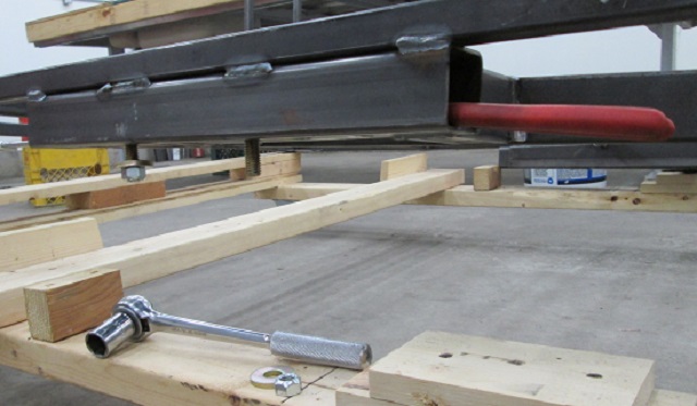

    Thanks guys for your ideas. In order to avoid complicated assembly when the original concept came to mind, I went out to the shop & tried it first before keeping with the idea. A couple of pictures that may show better of how simple it is to drop the bolt in place & hold it with the wrench:

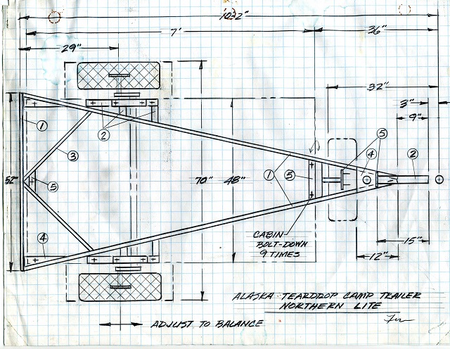

    If the body where not welded on the tow bar, but made of aluminum, wood or fiberglass, those same 2" tubes would be used to mount the body. The body bolts would go through the top of the tube in the same fashion as the axle bolts. This drawing is the genesis of the design showing the mounting bolt locations:

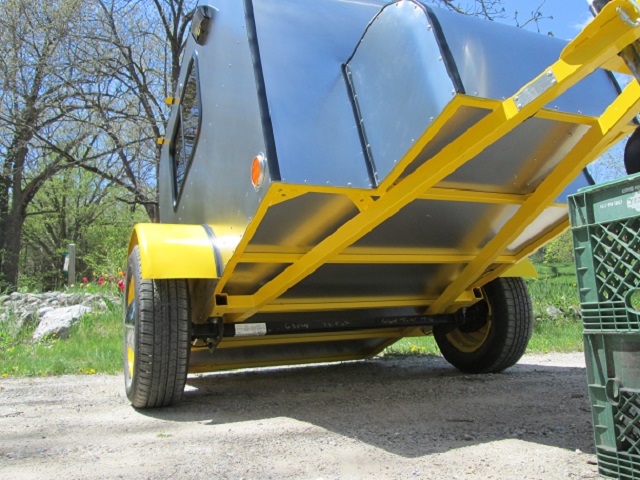

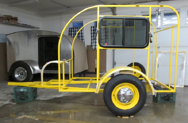

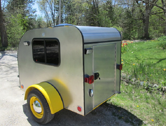

    These two pictures are of Stacie Tamakis' trailer with the steel portion of the cabin framing welded to the minimalist chassis.
    :peace: Fred

Postby KCStudly » Wed Feb 20, 2013 3:53 pm
Oooh, that looks nice. I'm sure that Stacie is going to be very happy, and that things are going to work out best for her in the end.
Great design and, IIRC, it really does look like what Stacie said she wanted! :thumbsup:

Postby deleted » Wed Feb 20, 2013 11:08 pm
It is just what I wanted! So lucky to have met Fred :shake hands: here on the forum. Every email update with photos he's sent me is like Christmas morning. And not only will my trailer be fantastic, I get to see what the country is like east of WA, OR, and CA. It's going to be a great adventure driving out to Michigan to pick it up.

Postby alaska teardrop » Wed May 15, 2013 8:01 am

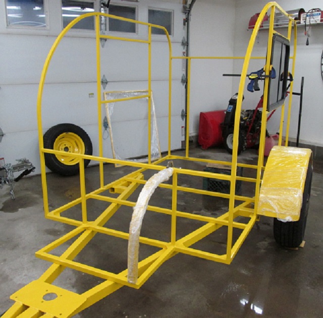

    Except for some cabinetry that Stacie plans to install, her trailer is completed. It weighs 554# with a tongue weight of 82#.
    :peace: Fred
