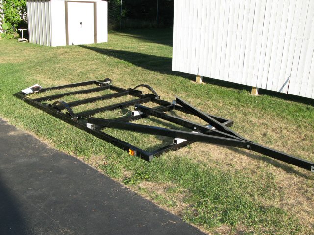

Postby TheDuke » Wed Aug 29, 2007 2:29 am
About the Red Trailer SJ-8535 (5x10 w/13" wheels)
From a previous post it sounds like there's difficulty putting the wheels where you want them. Are the spring hangers welded on at the factory, or are they bolted so that you can simply drill new holes?
Also, does it come with the triangular tongue assembly already welded on, or do you bolt it on after you get it?
Are the cross pieces 2x3 tube, like the perimeter, or are they something different?
Does anybody who already has one, have a picture of some of the construction details?
I could use any comments on the above.
Thanks

Postby TheDuke » Wed Aug 29, 2007 4:58 pm
:oops:
I think I could have read more in the forum, or email RedTrailer, so that's what I did.
The spring hangers are bolted and you can move them if you want.
The tongue assembly is bolted on.
The cross pieces are welded in place, and they are "C" sections, not rect. tube.
Thanks to the RedTrailer folks.

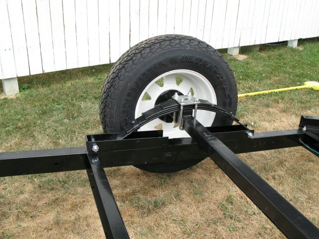

Postby mikeschn » Wed Aug 29, 2007 5:47 pm
My spring hanger channel was welded on. The bolts which actually go thru the spring and the channel could be moved, but not by much...

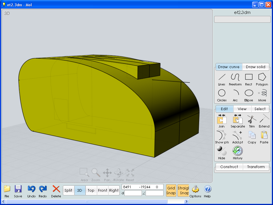

I have to get back to doing some cad work on that... this is the latest model I have, but there's not much detail in it yet.

I don't have your previous 3D versions handy, but it seems you have taken a little of the "droop" out of the rear roofline, as you revise things. I think it looks better with less "droop" in the rear.
I think it's going to be a "classic" shape. Just a feeling.
For what it's worth.

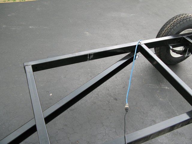

Looking at your pics, I noticed something I need to ask.
Your footwell is right in the same area mine wants to be (and seems to be deeper, another question) but it's wider (front to back) than the RedTrailer drawing of the frame. I think they show only 16-1/2" in between the braces in that area. Did you cut and move one of them?
TheDuke

Postby SamR » Thu Aug 30, 2007 2:21 pm
That's exactly the trailer I bought in April; the axel is a bit too far forward, and yes it is welded on and WAY beyond my skills to move. One of the reasons I chose this one was the powder coating, but I've noticed quite a bit of rust lately in corners, etc. Also, the plastic plugs they use in the ends of the channels pop out in transit, so I'm getting rust inside them as well. Wish I'd gone with the Red Trailer, but I'm also NOT very skilled and things have been known to fall apart strictly because I've purchased them... :oops:

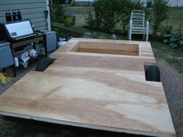

Postby mikeschn » Thu Aug 30, 2007 4:46 pm
Yea, I cut out the first cross member...
At the same time I cut out the notches...
Then I decided the dropped floor wasn't deep enough...
see next message
TheDuke wrote:Mike:
TheDuke
Postby mikeschn » Thu Aug 30, 2007 4:57 pm
I had some 2x2 tube laying around so I pulled the tongue off, and had the pieces of tube welded up in between. The made the area for the dropped floor 7" instead of 5". (That's 5" of steel plus 2" of floor)

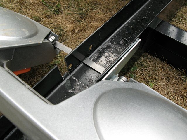

Postby mikeschn » Thu Aug 30, 2007 8:20 pm
To move the wheels I'd have to grind off the 2 channels. A big task.
So I ran the tongue balance spreadsheet, and my tongue weight was acceptable. So I left it where it was.
