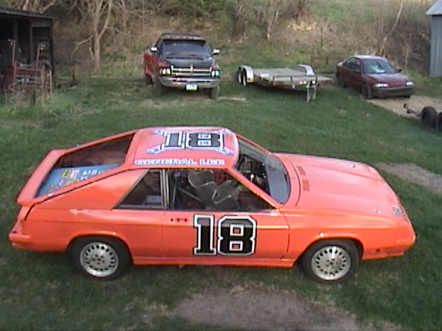

Not sure on the Chrysler minivans, but the front wheel drive Omni/Horizon/Chargers are a semi-independent axles, with the center section that twists. From working on my 86 Charger race car(dirt circle track) The rear spindles unbolt off of the axle with four bolts, a person would weld a piece of plate to the end of a pipe and bolt the spindles to the plate, but you would have to use the chrysler hub.
I hope no one takes offense at the paint scheme.
