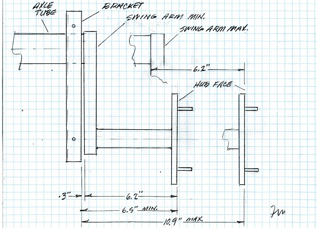

Does anyone here know if there is a standard (fixed regardless of the bracket and HF measurement) of the torsion arm to bracket clearance. I have a frame measurement of 71 1/8 and a outside cab measurement of 71 3/4. Just wondering if it's going to "rub" the cab with those measurements?
I'm looking at 10 down angle..

Gunguy05 wrote:Does anyone here know if there is a standard (fixed regardless of the bracket and HF measurement) of the torsion arm to bracket clearance. I have a frame measurement of 71 1/8 and a outside cab measurement of 71 3/4. Just wondering if it's going to "rub" the cab with those measurements?
Thanks,
    Brian, The difference between the torsion swing arm & the body is dependent on the difference between the outside of the body & the hub face dimensions. Assuming a #9 axle, the dimension from the hub face to the inside of the swing arm is 6.2". I'd recommend a mounting bracket measurement of 71 1/8" & a hub face measurement of 86". 86" - (6.2 x 2) = 73.6" - 71.75" (body) = 1.85" divided by 2 = .9" clearance between body & swing arm on both sides. This should also allow reasonable clearance between the body & a normal size trailer wheel & tire.

So from what I understand then, the 6.2 is constant for that particular axle, and they increase the length outside the brackets by adding material between the bracket and the swing arm?
That will make the tires track a little farther to the outside than I had hoped given the backspace of my rims/tires, but if that means I don't have to notch the wall cab and can do the 10 degree dn, rather than the 22.5 dn, then I guess I will make that compromise.
BTW: Where did you get that 6.2 measurement? Is there some dexter literature I missed somewhere? I looked all over for it, and could find side profiles of everthing, but nothing from the top down view.

http://l.b5z.net/i/u/6149609/f/Trailer_Axle_Resources/Torflex_Information.pdf pg. 3 has the #9 std at 6.5 and the short at 6.0 minimum.
    Fred
So from what I understand then, the 6.2 is constant for that particular axle, Yes and they increase the length outside the brackets by adding material between the bracket and the swing arm? Yes. The axle tube extends through the bracket to the swing arm. How far depends on the difference between the hub face & bracket dimensions that you call out when ordering.That will make the tires track a little farther to the outside than I had hoped given the backspace of my rims/tires, consider using zero offset trailer wheels. but if that means I don't have to notch the wall cab and can do the 10 degree dn, rather than the 22.5 dn, then I guess I will make that compromise. Because your body is wider than the frame & mounting bracket, you would not have clearance with either start angle at full shock load if you use the minimum overhang (6.5"). Where did you get that 6.2 measurement? Is there some dexter literature I missed somewhere? I looked all over for it, and could find side profiles of everthing, but nothing from the top down view. I no longer have a link that shows the dimension. I guess you'll have to take my word or go measure an axle.

Thank you! I had a hard time wrapping my mind around it... and I didn't doubt you on it. I just wondered how it all fit together and within what specs.
Sounds like exactly what I needed to know.. Now I know the right questions to ask when I call Dexter back, so as to get the right answers. Yesterday's phone case seemed a little uninfomed on both ends of the converstaion.. admittedly I didn't know what the right questions were to ask, but I wasn't really led in the right direction either.
Thanks again for the help, and drawing.... I'm sure it will help others out as well.
