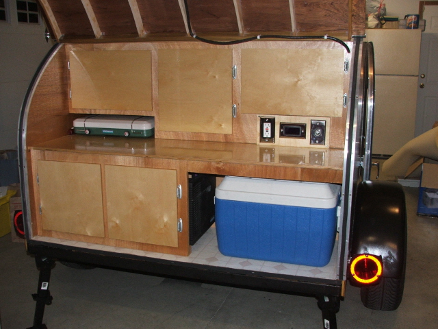

Postby bledsoe3 » Thu Aug 02, 2007 2:16 pm
It's hard to tell from these pictures, but I did mine at an angle as suggested.
http://www.tnttt.com/gallery/image.php?image_id=18848
http://www.tnttt.com/gallery/image.php?image_id=19100

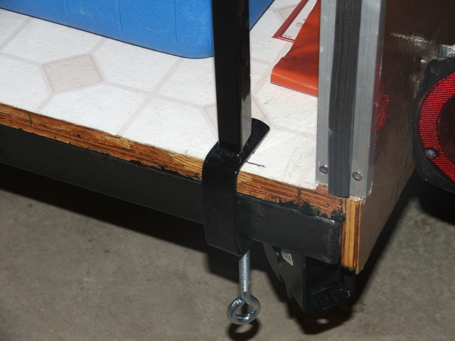

Postby Ken A Hood » Fri Aug 03, 2007 10:20 am
I cheaped out and bought these stabilizers. I plan on getting a pipe and welding up pieces in the 4 corners so the stabilizers have a pocket to fit into (and won't slide out)
