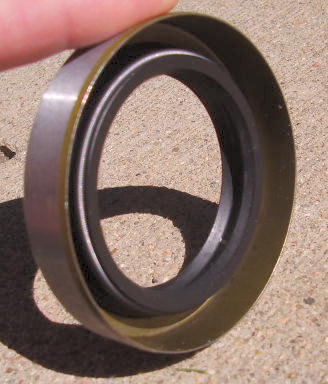

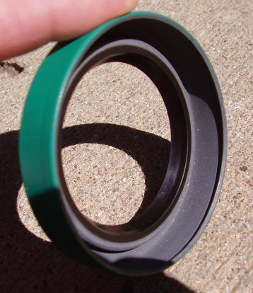

I grabed a couple of pictures of the two seals that would work on my axle.
This first picture is the NAPA seal. It is a single seal.
This seal was bought at a trailer shop. It is a double seal and the inner seal has a spring to keep the grease in.
