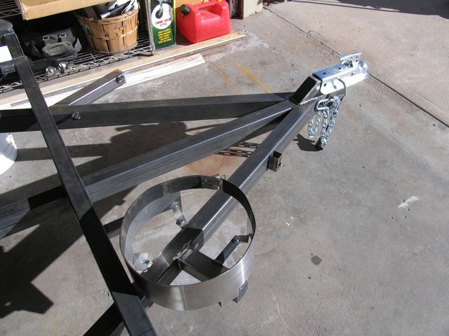

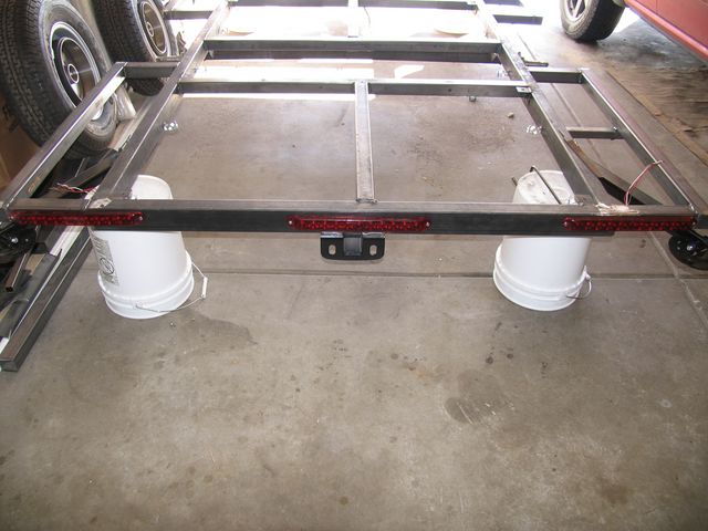

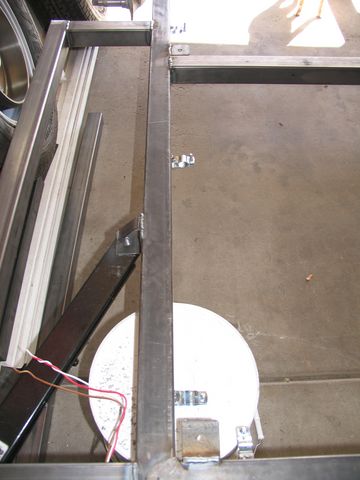

Postby bdosborn » Sat Jan 05, 2008 3:01 pm
Been making some slow progress on the tricky stuff:
I've got the taillights mounted, supports to bolt the trailer body to and brackets for trailer wiring smurf pipe. I've also got the propane tank holder built as well as supports and mounting points for the tongue box. I've also got the tongue box about half done. Oh and I welded on the break away chains. That was kind of tricky welding, I hope its strong enough. Just need to finalize the propane piping locations and I'll be ready to prime and paint.
