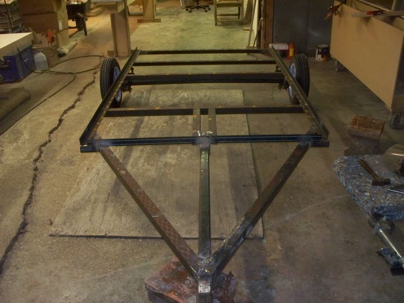

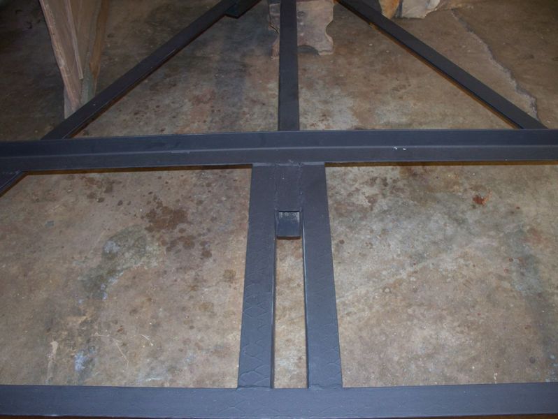

My 5 X 8 TS trailer mod...used some of the angle that I cut off the top rail plus one of the cross members to make way for a floor drop...I notched the front rail for the 2x floor framing to extend through...

oakinteriors1 wrote:My 5 X 8 TS trailer mod...
You haven't done much to make the tongue mounting stronger than it was before - and this trailer has given other forum members problems before. The new tongue itself may be strong enough, but the bit of the trailer it's attached to is the problem.
The test would be to support it as in the photo (on the wheels plus under the coupler) and then jump up and down on the back end of the tongue (as long as you are not a lightweight -if so, find a heavy friend) - doing that caused a bend in the second cross-member for one forum member, and it's a reasonable test to expect the tongue to pass.
angib
5000 Club
5000 Club
Posts: 5783
Images: 231
Location: (Olde) England
Re: 5 x 8 trailer tongue upgrade
Postby KCStudly » Mon Oct 07, 2013 2:58 pm
Separating the vertical legs of the side rails from the front xmbr with the notch will have weakened the side rail strength quite a bit, too. Even though you added back the little piece underneath as a gusset, it does not help prevent the vertical legs of the side rails from splaying open when a bending load is placed on the rail (such as from leverage at the tongue). The cabin will stiffen the frame over its length, yes, but the area local to the tongue tie in point is still a concern.
I would much rather have seen you leave the front xmbr intact and have the gussets extend the front of the side rails forward, then you could have made a separate wood frame out over the tongue and tied this to the main wood frame with the top skin. The side walls would then tie the two floor frames together and keep them from folding at the front xmbr.
There are a few other reasons why I personally don't like the idea of converting angle frame utilities for camper service, but that is another thread.
Either way the wood will help strengthen the frame. A few well placed fasteners (not too big or they will actually weaken things more) between the wood and steel should make it okay; just be sure to seal everything well and keep water from collecting between the wood and steel.
