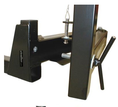

Here are some pix's for you Print out the one
Look in my album for shots 1 and 3
The conncetion bolts I find interesting.
I got these from http://www.etrailer.com/
they offer sever brands. this is by hidden hitch.
Show them these and the one that Del offered and of course Ol' Bitty's.
Ron
