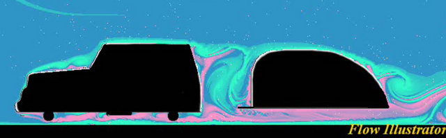

Putting the axle in the right place is only step one. Yeah a multilink might be overkill but inward tilt steer would help stabilize the trailer and it can be done in other ways. Negative tongue weight isn't the problem, it is about increasing the range of stable operation, simply the faster you go the more energy that can be put into throwing the trailer and the harder it will be to bring things back under control. If by using the other design elements such as aerodynamics, suspension design, reducing polar inertia, lowering center of mass, lowering hitching points,... you can increase your safe operation range you will also be able to bring things back under control faster and more easily when something does goes bad.
