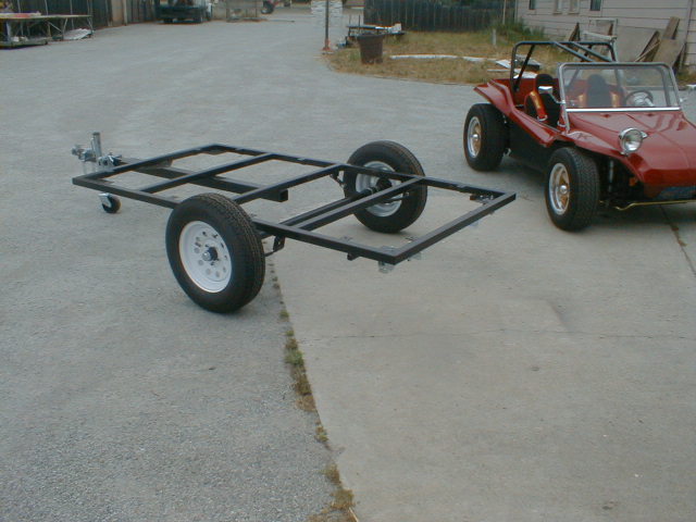

If I ever am fortunate enough to have a frame custom built I will follow in Planovets footsteps. The frame c channel becomes the vee tongue there is no way this one is gonna fail. I really liked this setup. I put it in my album to show my welder guy if the day ever comes.

I used 2x2 x.120 for base frame, and uses 3x3x.120 for mono tongue.... Plan to "off road" it a bit. I think the vertical wall strength of the 3 inch tube will be enough... And Yes I would run main tongue member to at least a second cross member, it would reduce the torque leverage on first cross member considerably....

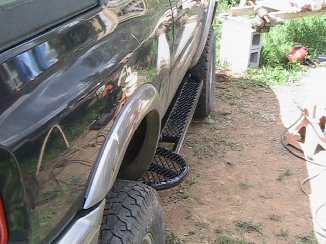

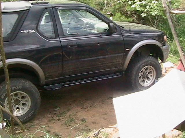

Postby bansil » Thu Jun 03, 2010 11:55 am
since you mention "offroad" and "rock crawling" I would go with .120 wall for sure as a minimum for any tube that can contact a rock the thinner tube (.078) will dent and rip open.....the sliders i build are 2x3x3/16 tube with 1 1/2" x .120 "steps" the steps will dent, the slider it's self will not.
These allow rocks etc to slide around and not get stuck between tires,I plan on something similar this winter for my trailer.
any bending/failure of tube could hurt integrety of the "cabin area"
just my .02
Here's an example:
Also make sure to reinforce the front spring perches so if a tire gets hung up you won't rip mount off frame or bend it.
