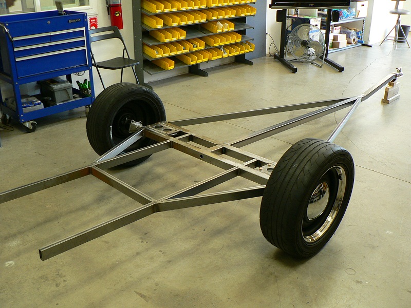

Just curious, what tubing are you using? What is the (estimated) frame weight?
It's all 14 ga mild steel; 2 X 2 and 1 X 2... I don't have total footage of the different tubing near me at this time. I'll weigh it when it's welded together.
I'm going to cut some small, almost half-circle plates to mount longitudinally on the opposite side (bottom side) of the axle plates on the ends of two 2 X 2 crossmember tubes. There is some concern that the 2 X 2 will twist, or warp, if only the top side is welded to when the half-axle plates are attached.
I should be able to report back tomorrow after a good metal fab guy has a look at them... I'm driving 40 mins to go see him tomorrow afternoon.

Postby eamarquardt » Sun May 23, 2010 1:42 am
It looks like the only connection between the fore and aft frame members to the axle cross members are butt welds. Intuition and experience tells me that relying on butt welds between pieces of thin wall tubing at the most stressed part of a trailer frame is not good engineering/design practice. The three MEs (and one senior at Cal Poly school of engineering) that I showed your pics to, shared my concern. They all recommended adding plates/gussets above and below the tubes to tie them all together.
I'd seriously consider the thoughts of these engineers (PhD in ME and professor at CSUN after 35 years at Rocketdyne, ME with 25 years experience at Rocketdyne, and the others) and add reinforcing plates top and bottom to tie all the tubes together.

Postby teardrop_focus » Sun May 23, 2010 1:36 pm
Good sense will then prevail.
I'll fab up some plate gussets to bridge the crossmember, connecting the front and rear frame assemblies. Squares, on a diamond, with triangular cutouts - to avoid collecting water (and to save weight) - would be the ticket...
Please remind your rocket scientists that when it comes to the typical teardrop's wooden monocoque structure, one could almost bolt a tongue to the front and an axle to the aft midsection and it would work. Almost.
Remember this is an 1100 lb rig. It is not heavy.

Postby eamarquardt » Sun May 23, 2010 4:16 pm
teardrop_focus wrote:Please remind your rocket scientists that when it comes to the typical teardrop's wooden monocoque structure, one could almost bolt a tongue to the front and an axle to the aft midsection and it would work. Almost.
All we know is what we have pictures of. W/O knowing the details of the box everyone else that comments is "flying blind". Rocket scientists have to get right the first time so they play it somewhat safe sometimes. Your teardrop may start out at 1100# but it may put on weight. When I bought our boat it floated about 2 inches higher than it did 10 years later. When I unloaded all the diving gear, spares, extra sails, dingy, outboard, etc., etc., etc. it returned to it's original waterline.
"Big"Guy's suspension is bottoming out (he's promised to let me fix it when he returns to the area) and has caused his frame to bend a bit. His "box" is also suffering damage due to the flexing.
You're planning on adding the gussets so you must agree (at least a little bit) that their comments are valid.

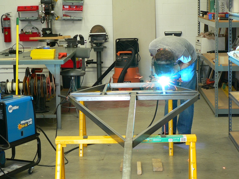

I left the crossmember bits with Mr. Fabricator... 'cause he seemed to think it'd be fine. And the tubes didn't warp; he stitched alternately top and bottom, 1 inch each.
Others here on T&TTT whom I have spoken w/ in PM have said too that the planned chassis is fine as is; that no additional gussets or plates are necessary.

I’d also like to make a couple of comments on the last frame posted. Dad-gum I wish I could weld like that and it looks like there is plenty of beef there (in my own professional opinion).

[quote="kennyrayandersen"] Dad-gum I wish I could weld like that.../quote]
Practice practice practice, and a good welder helps too.
Remember, those are profesional welds.

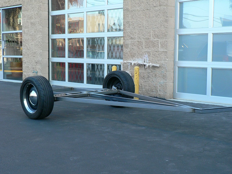

The rest of the chassis has been welded by a different person; a friend of mine who has welded many, thinner-wall 2 X 2 tubing structures for dynamic motor racing simulators...
Wheels arrived (3 weeks late, among other issues, but...) they look nice in black primer... with stainless beauty rings and inexpensive chrome baby moons.
Again, this design also depends on (at least) a plywood H-beam (I-beam on it's side) to add beam stiffness and was never intended to serve as a utility trailer in the usual sense of service. It is strictly a chassis for a teardrop trailer that sleeps two forward of the axle, has a well-equipped galley aft and one posessing minimal tongue weight. The teardrop body can and will be moved aft if necessary... (since we cannot now move the axle).
