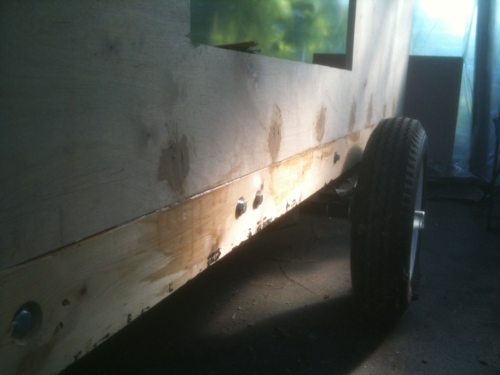

i bought the northern tool bolt together 5x8 that you're looking at & other than needing to get better tires it's unmodified... (bear in mind i'm still in the building stage though...)

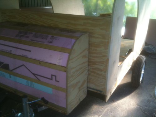

i built a front storage box on the tongue which is a bit heavy itself... to add weight up front & well... for storage! :lol:
i bolted 1x4's to both sides... both to help support the 3/4" ply walls & to keep a true 5' width on the inside & as much headroom as possible... not seen in this pic, but with the stock fenders on the door bottom clears by a couple inches...

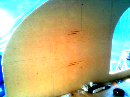

as for the galley, i'm planning to keep it fairly simple & light... you can sorta see the tentative design here...
also, rather than putting full-on cabinets & such in the galley initially i'm gonna raid the plastic storage drawer/ bin department at target... i figure that's a cheap & light solution while i get used to how the camper behaves while being towed around.
