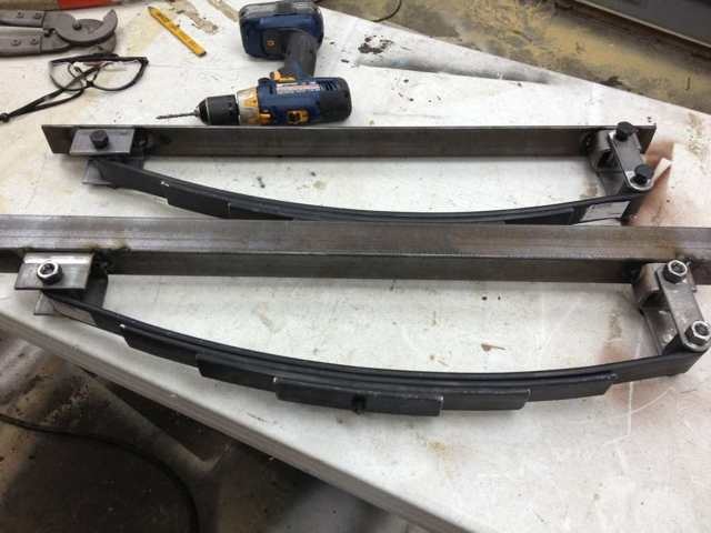

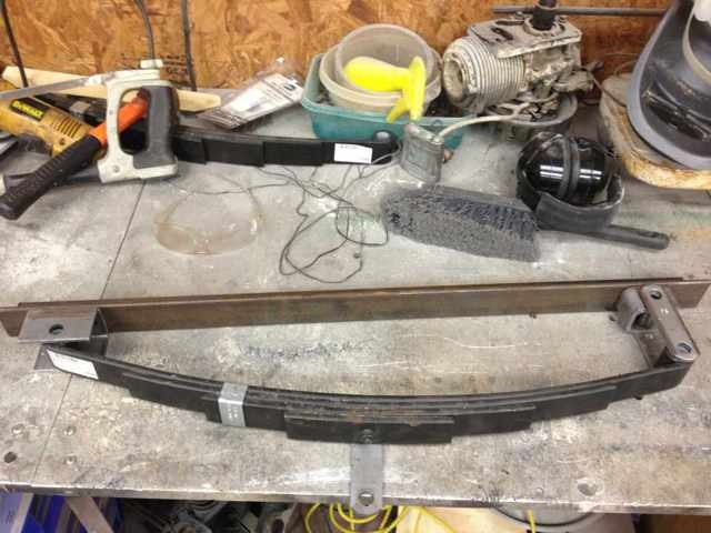

Today I was able to get everything mocked up on the springs. I am using the angle to weld everything on then bolt it to the frame.

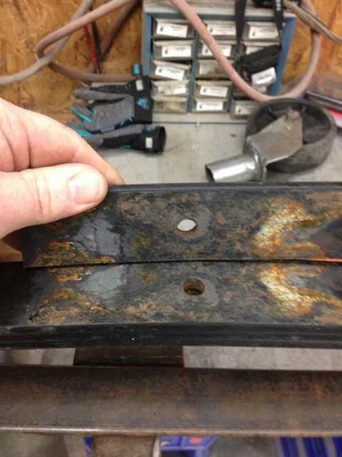

Took the springs apart to wire brush and round the edges like Rob suggested and this is what I found.
After getting them cleaned up and put back together I was able to get the hangers tacked on. I set the swinging hanger at the same distance as the the leaf. Going to set this under the trailer and put weight on it to see the angle on the shackles.
If anyone find's anything I am doing wrong. Let me know.... Till next time....

Postby KCStudly » Wed Apr 03, 2013 7:48 pm
I am very pleased to see that you have the shackle hanger bracket oriented properly so that it is self gusseting and resists crushing. :thumbsup:
Most people get this wrong. :cry: :roll: :thumbdown: :frightened:

Postby 48Rob » Thu Apr 04, 2013 7:08 am
I've never seen the rear spring hangers installed sideways like yours...but I don't see why it wouldn't work.

Postby KCStudly » Thu Apr 04, 2013 2:45 pm
48Rob wrote:I've never seen the rear spring hangers installed sideways like yours...but I don't see why it wouldn't work.
Rob
Like I said, that is the correct way. Most people get it wrong.
Re: Broken leaf spring
Postby Fishingtomatoseed » Thu Apr 04, 2013 5:51 pm
To be honest I would have done it the other way. But the hole in it was offset to one side. So I looked on etrailer web site and they showed how to mount it. Good thing for instructions.
