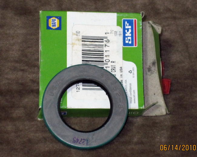

Unless your local NAPA dealer just doesn't want to bother, he can get about ANY bearing/Seal from the nearest NAPA warehouse. My younger son has a NAPA store & when I needed to replace the seals on my HF 1740# trailer he measured the old seals (30x52x10) & ordered them from the warehouse. He also ordered the next lower & next higher sizes as his experience is that used seals don't always measure out correctly. The measured 30x52x10 turned out be be too tight to easily go on the spindle even with moderate force applied. The 32x52 fit correctly but the 10mm thickness wouldn't seat properly in the hub so we went to 8mm thickness. We are fortunate to have a NAPA warehouse locally but even if not local, your NAPA store should be able to get 'em within a couple of days. The correct seal for MY HF 1740# is 32x52x8, NAPA part # 12745. I've pulled my TD more'n 6K miles since the last bearing re-pack/seal replacement (& 12K plus before that) with no problems or grease leaks. Accurate measurement is important & a helpful dealer can be of invaluable assistance in acquiring the correct part(s)...

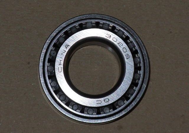

Original bearing - #'s correspond to a NAPA catalog #

Pulled the bearing out of my new HP 1740# today. I was cleaning the bearings when one of them came apart. I am sure I can reassemble it no problem. Is the fact that it came apart a problem waiting to happen? I personally don't think it is because the raceway is basically there to keep the bearings in place.
Any opinions?

wingloader wrote:Pulled the bearing out of my new HP 1740# today. I was cleaning the bearings when one of them came apart. I am sure I can reassemble it no problem. Is the fact that it came apart a problem waiting to happen? I personally don't think it is because the raceway is basically there to keep the bearings in place.
Any opinions?
Thanks,
Joe
you can for around $250 get a new axel with hubs that have american hubs and bearings. But you have to ask a RV parts place or dealer for the price and ask several so you know who is in for the bucks. I may do that in the future. You need to take the trailer in to them so they can measure and get you the right one.
But if the Bearing fell out I would be replacing it, you do not want it pop'n out at 55+, if it gets to hot it will weld to the spindle and lock the wheel.
Several of the folks have said carry a spare Hub all greased and ready to go. or get a sealed bearing.

Okay, maybe I jumped to a conclusion prematurely.
Did the inner race and rollers fall out as a unit? That's not a big deal. Just clean thoroughly (and I mean not a speck of anything; nothing foreign), inspect for abnormal wear, nicks, pits and/or signs of heat. If good, re-grease with impeccably clean grease.
If the roller bearings all separated from the cage and came apart from the inner race (which was my original interpretation), then I stand by my earlier assessment; junk.
To recap what has been said many times:
When replacing wheel bearings be sure to change both the "cup" (outer race) and "cone" (inner race with bearing cage assembly). Most good parts houses can press the races out/in for you for a nominal fee. If that is not an option, or you are familiar with the process and have the correct tools, you can do it yourself. It can be tricky for a novice. Do not hammer directly on either of the parts at installation. Use an appropriately sized socket or bearing driver (the old race can be used if it is ground down on its OD so that it is a slip fit to the bore); preferably an aluminum mandrel, or brass punch in a pinch. What ever you do, do not mushroom the outer race, or you will be doing the job again very soon.

The cage simply came off. The rollers and the inner raceway are in perfect shape. The cage is just there to hold things in place when the bearing is out. I will just use grease to hold the rollers on the raceway and carefully put the cage back over the bearings.
Someone mentioned a NAPA part number 12745 for a new bearing seal. Picked one up yesterday to replace the original one that I damaged removing it. Dumb question...WHY THE HECK doesn't HF ship the bearings and seals in separate packaging!? Duh.
