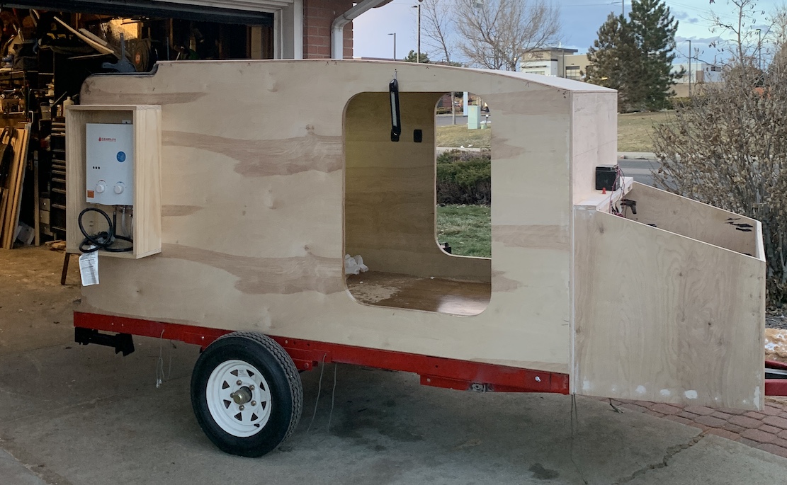

My build is on a HF 4x8 trailer that has been reinforced with welds and a longer tongue that extends back underneath the trailer. I can certainly reinforce it more if necessary to install Timbrens. If someone can help me understand what I'd need to accomplish this, that would be awesome. Will Timbrens for regular tires using a spacer do what I need? Is that what the original poster did?
Here's a recent shot of my camper below. I'd like to get my Timbren setup complete and then fabricate my fenders around the setup.
