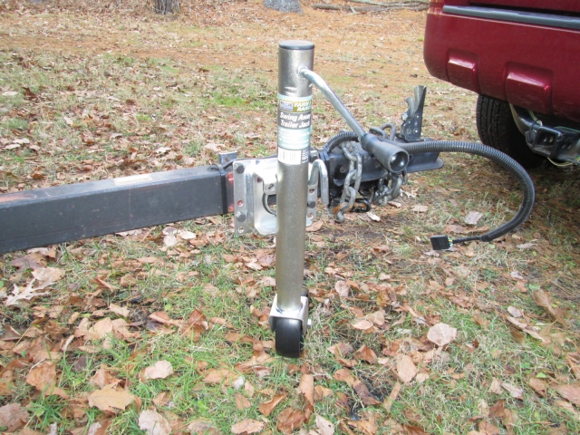

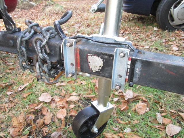

I replaced the tongue jack on Saturday. Reese 1k lb wheeled side crank from Tractor Supply.
I shortened the C-shape clamp bars to remove the excess that would otherwise hang down, deburring and rounding over the cut on the Bader sander. They came out nicer than the old ones that I had whacked while in place.
Also, looking at the instructions I found that the old ones had been put on backwards. By turning the clamps with the legs of the ‘C’ facing out, I was able to trim another 1/4 inch off of the bolts to where they hardly stick out at all. I also reused the original SAE bolts with self-locking nuts, rather than the new metric ones.
All better now.
