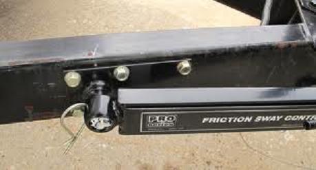

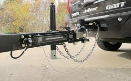

bobhenry wrote:... a sway bar is used on the 3000# to 7500# big monsters and only attach to a class 3 or even 4 rated hitch. Just take it back !
I see it a little differently; if a trailer-tow vehicle combo is more firmly connected together (to eliminate excess side-to-side movement, or up-and-down lurching), whether by a sway bar or by a weight distributing hitch, then a safer and less worrisome trip will result. Over the years I have learned to rely on both the sway bar and weight distributing hitch on all my towing combinations, whether there is no load or extreme loads. Encountering switch-back roads, taking evasive maneuvers, or repeated dips and rises (whoop-de-doos) in the road all can cause the trailer (any trailer) to suddenly become the "tail wagging the dog", at least momentarily. With experience towing, and proper load balance, most people can do without these aids for common trailer towing. But, why not take advantage of their help, and use them anyway, just in case? I adapted my wd hitch for use on my TTT (a single beam drawbar)
  • 110141
  • 113091
, though I tested it without it, and it tracks fine either way. However, when I crossed over a sudden large dip on a county backroad, I was glad I had the wd connected and tensioned, since it basically controlled/smoothed the expected excessive bounce of the little trailer to a minimum. I haven't yet adapted the swaybar to the TTT yet, but I will before I take it out on my next trip...just in case. If you decide to use the swaybar on your 1.25" Class 2 hitch, there's an adapter for it
at E-trailer. http://www.etrailer.com/Accessories-and-Parts/Reese/RP26005.html
To avoid confusing the poster , he was asking about a sway bar not weight distribution systems
(on a 600 pound trailer :? )
I do wish to thank you, I was un aware there was a small plate adapter for the friction sway controller for the lighter class hitches until your post. All I had seen were incorporated in the weight distribution head.
You might look into the adjustable drop ball mount as shown in the above pictures your set up appears to be 7 to 10 degrees nose up and combined with the relatively short tongue it may not have the desired road manners due to these factors
