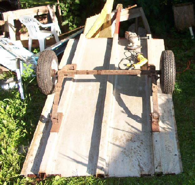

KCStudly wrote:Love the added coil spring and super sketchy upper mount for same in the pic Rob posted.
Not only that, but is that the tip of a fence picket ? :shock:

Postby KCStudly » Sun Mar 29, 2015 3:31 pm
One last dig; take a look at the U-bolts holding the coil spring perch to the axle. Long enough, ya' think? :lol:
I guess I shouldn't throw stones; at least they were out camping!
Re: Wooden Frame
Postby 48Rob » Sun Mar 29, 2015 3:42 pm
You forgot the muffler clamp... ;)
I've had that picture for years, been holding on to it 'cause I knew sooner or later it would be good for something!
It sure is a good guide on how not to add coil springs!

Postby KCStudly » Sun Mar 29, 2015 3:50 pm
One last one last; ...and the stack of washers under the nuts on the U-bolts of that muffler clamp.

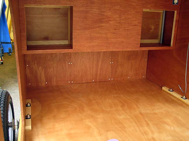

So have you had any problem with the holes in the floor wobbling out from the impact of hitting bumps on the road?
I actually was thinking about a welded tube triangle tongue. and bolting the half torsion's thru a solid block of hardwood in the floor. Maybe sleeve the bolt holes with a pc of round steel tubing the thickness of the floor.

Postby jonw » Mon Mar 30, 2015 9:06 am
TrailerEd wrote:I see! Thanks for sharing!
Ed
The torsion axle holes go thru the floor and a 2x2 block of wood cleat that joins the floor and the wall, and a thick metal washer plate. The bolts have lock washers and nuts on them so there's no loosening or slippage after 20,000 miles so far. I check them for tightness at the beginning of each season.
You can see them in this picture:
The tongue is bolted thru the floor in 4 places also through washer plates on top of the floor and it too has been fine.
The stiffness and dimensional stability of the 3/4in marine ply floor has a lot to do with why this works (IMHO).
