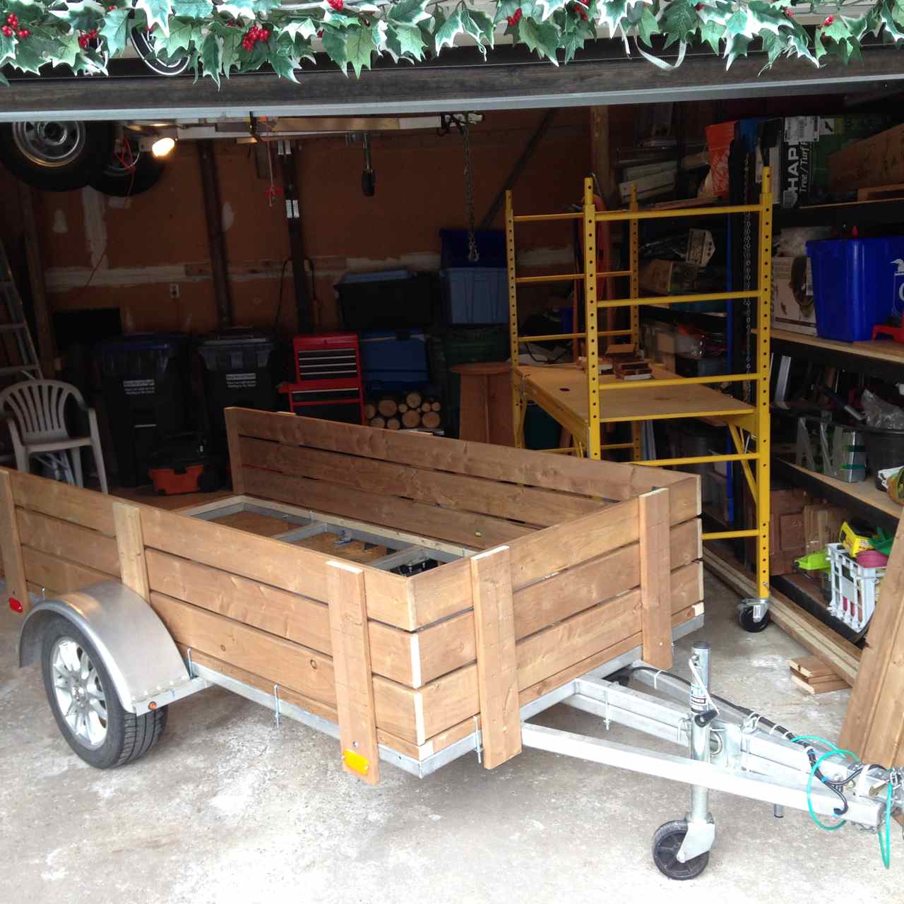

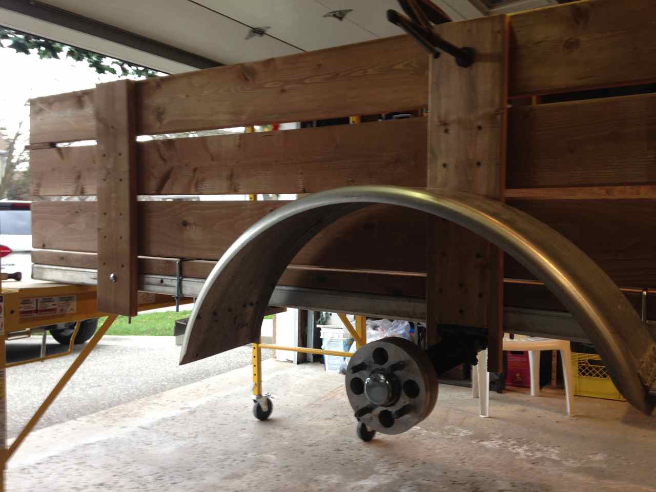

1 by six pressure treated decking board, its great for the job, all the wood is clamped to the frame with 10 standard u-bolts (*plus 4 bolts in the frame)
brand new same Flexiride 930lb adjustable spline half axles, same wheel spacer adapters from the original stripped down version

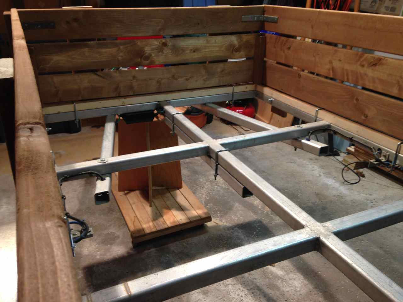

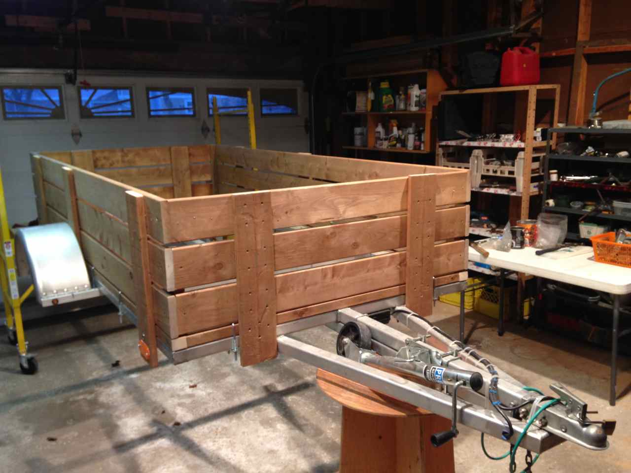

wires on the tongue still to be fished into the junction box to fully clean up the look

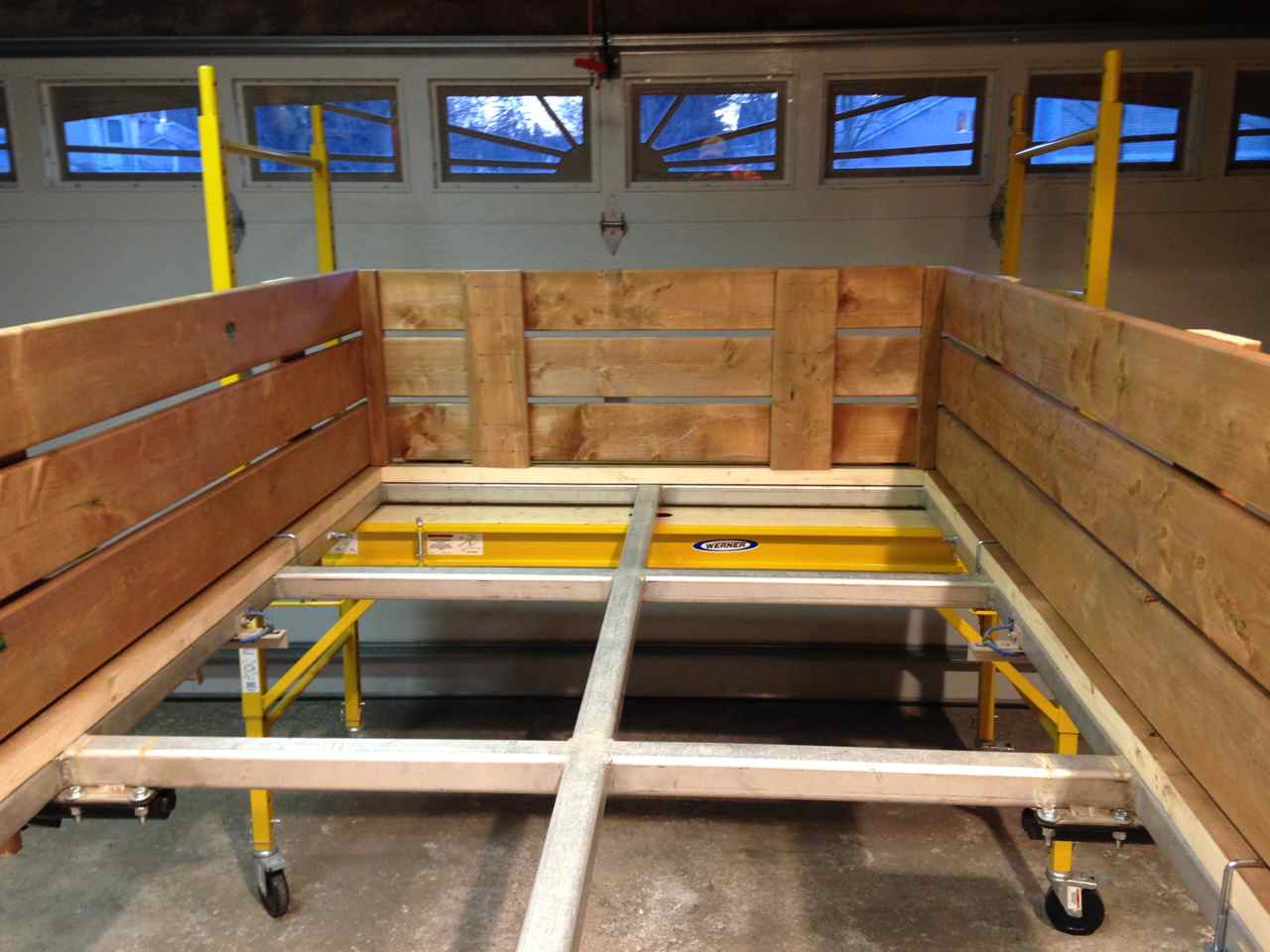

my design approach is there to be seen - hopefully simple
won't hold much, but that box is about 4 foot four by 8 foot nine so she'll fit some plywood and osb and whatnot without pinching the fingers
its light its less than three hundred pounds for sure, and remember i can take these 10 standard u-bolts & 4 lag bolts off, drop the cabin back on & 8 lag bolts and go for a road trip ;) until then.. the barn fenced stripped down aluminum half axxed laydee is back on the road logging miles ;)
