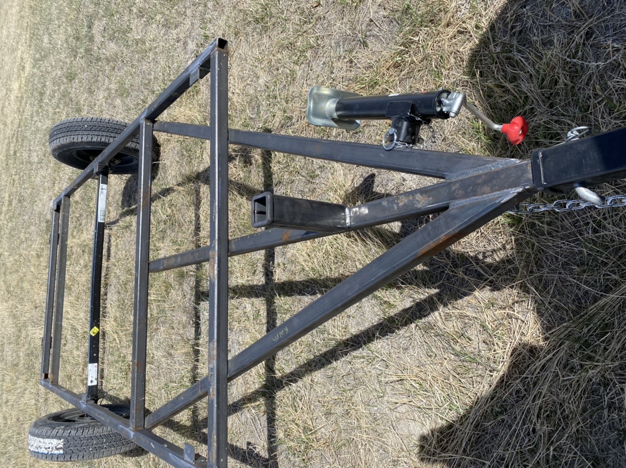

I think Tony’s plans are nice. I am incorporating them in my build. Just picked it up from a ranchers shop two days ago. The welder had nearly zero questions.
I would call this more Ranch Tough than light though.

western traveler wrote:I would call this more Ranch Tough than light though.
Nice welding. But I would weld the front of any connections that face into the direction of travel. The Y that ties into the tonque. Where it meets the cabin frame needs welded to the Y. He did side weld's but that does not keep wheel thrown trash packing that unwelded connection full of debris and rusting the tubes out.

Philip wrote: Nice welding. But I would weld the front of any connections that face into the direction of travel. The Y that ties into the tonque. Where it meets the cabin frame needs welded to the Y. He did side weld's but that does not keep wheel thrown trash packing that unwelded connection full of debris and rusting the tubes out.
Welding across the drawbar tubing runs the risk of warping the tubing. Better to run some seam sealer in there before painting.
