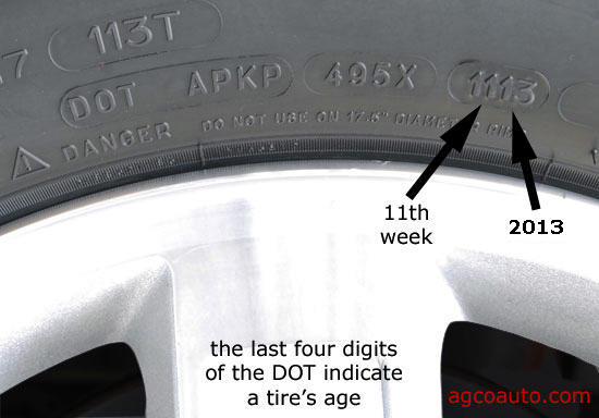

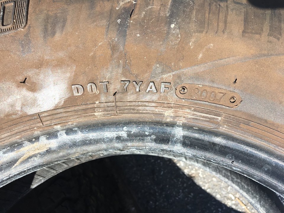

Postby swoody126 » Wed Feb 03, 2021 8:50 am
Squigie, this is not meant to be argumentative butt...
¿ do you know how to read the age of a tire ?
it is now molded into each tire sold here in The States
on the sidewall there is a DOT number molded into the rubber and at the end of that number(usually in an oval stamping) there are 4 digits that tell the week and year the tire came out of the mold
the 1st 2 digits signify the week of the year and the last 2 signify the year
here are a couple pics explaining the stamping
i have found old stock being sold as "new" from time to time
not saying that's what you got
just offering information for future reference

Re: My wheel came off!
Postby Squigie » Wed Feb 03, 2021 12:32 pm
swoody126 wrote:Squigie, this is not meant to be argumentative butt...
Yes.
As I said in the text that you quoted, it was less than eight months old.
Squigie
Posts: 403
Location: Southeastern ID
