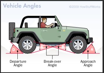

There is a little value in having slightly higher clearance than the Jeep.
A theory over here is that dingoes' heads are the widest part of their body, so where the head fits the rest can follow.
I guess the idea applies to a car/trailer combination.
You do want the trailer to not be the limiting factor - you want it so that if the Jeep gets through, the trailer will follow.
But actual vertical clearance height is possibly not the issue.
I don't know what they call it in the US, but here in Oz we talk about approach/departure angles.
Those need to at least match your jeep, I'm thinking.
The angles are influenced by the clearance height, but also by the length of your overhangs.
It's why you see a lot of off-road trailers with the an angled cutaway at the bottom rear.
Consider the breakover angle too - a long draw bar (tongue?) on the trailer reduces the breakover angle between the Jeep and the trailer.
Of course a too short drawbar isn't good either.
I borrowed the attached drawing from a Quora post - hopefully they won't mind.
