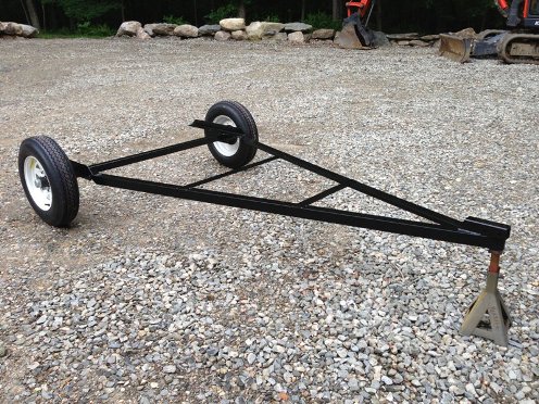

Design_Library/The%20Ultralight%20Chassis.htm Here is a link to the ultralight frame.

I may weld that frame for a box of screws :thinking:

Isn't there a trailer chassis design that is just a triangle? I might be able to swing getting help for that...
Thanks for the advice anyways, I was hoping to see how cheap and light I could get the trailer which is basically a bed on wheels. I can get it under $800 if I salvage a used frame, but I also still want it light enough that my car tows it without struggling.
