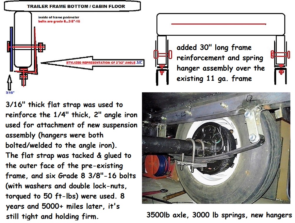

I did something similar when I attached a new axle, springs, and hangers to my original frame. I used a 3/16" flat strap (to spread the load to prevent crushing the 11 gauge original frame), and 1/4" thick angle iron (2" legs) to weld & bolt-on the new hangers to it. No problems many years later. Not wanting to blow-through the thin steel of the old frame with extensive welding (my first time), I simply tacked on the 3/16" strap and used PL adhesive to secure it, before bolting thru with six 3/8"-16 Grade 8 bolts to hold everything together, with 50 lbs torque, to not further crush the already damaged frame. It hasn't moved a bit in 8+ years.
flat strap + angle iron over existing 11 gauge frame.jpg (311.05 KiB) Viewed 498 times
