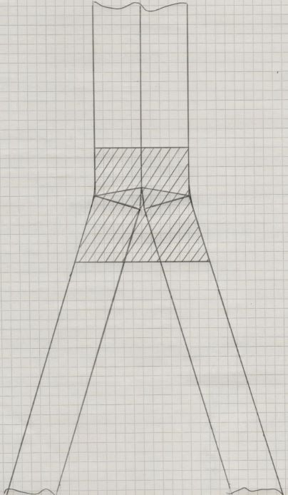

Time for some more details
I looked at the chassis near the coupler and I've simplified that and eliminated the 2x2member and combined the (2) 1X2 into a 2X2 to be compatible with the coupler. THe frame would be cut, bent, and new pieces welded in combined with a 1/8 6061 plate welded top and bottom to reinforce the welded area. Since the weld area is very close to the coupler (load introduction point), the post-weld and aged properties will be sufficient to support the applied loads.

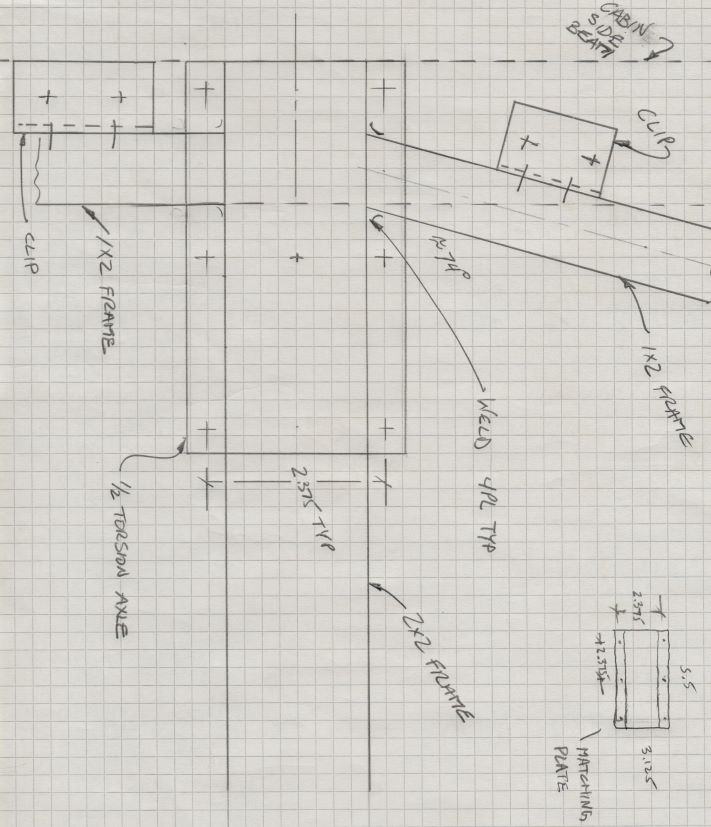

For the frame side rail to axle cross member detail, it allows the installation (bolting) of the Flexride 1/2 axles rated at 425 lb (FF-425-1-S). There is a matching plate (FS30-2). The idea would be to mount the plate on top, and the axle on the bottom of the 2x2 cross member
ult_lightweight_frame_aft_detail - sm.JPG (88.91 KiB) Viewed 2343 times

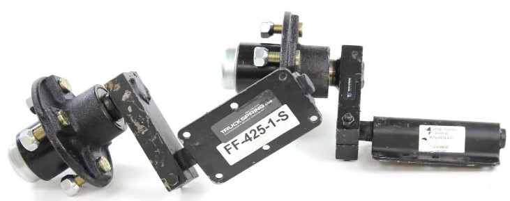

flexride FF-425-1-S.jpg (56.79 KiB) Viewed 2343 times
The welded are in an area with low bending stresses so the reduced allowable won't be an issue. Note the clips that will joint the frame to the cabin. The fasteners that attach the clips to the frame will be in-line and go through the center of the beam. In this area the bending stresses are very low so the fatigue stresses will be lower than the endurance limits for 6061.
In summary we don't have any welds in high stess areas, not are any fasteners located in high stress areas; furthermore, we don't have any welds located in high stress areas, so the fatigue life should be the life of the cabin! Next we'll look at where we are on weight. I'm waiting to hear back on a weight for the FF-425-1-S (I think the 4-4" version is 25 lb and the 5-4.5" lug pattern version is 27 lb). Can anynoe confirm that?

Postby twisted lines » Tue May 02, 2023 11:11 am
I will try and weigh mine. 1000 K lb
23 lb 11 oz No Grease With nuts.
Racking up; And Rapin foam
twisted lines
Posts: 1243
Location: Jefferson
Re: ultra lightweight trailer chassis concept

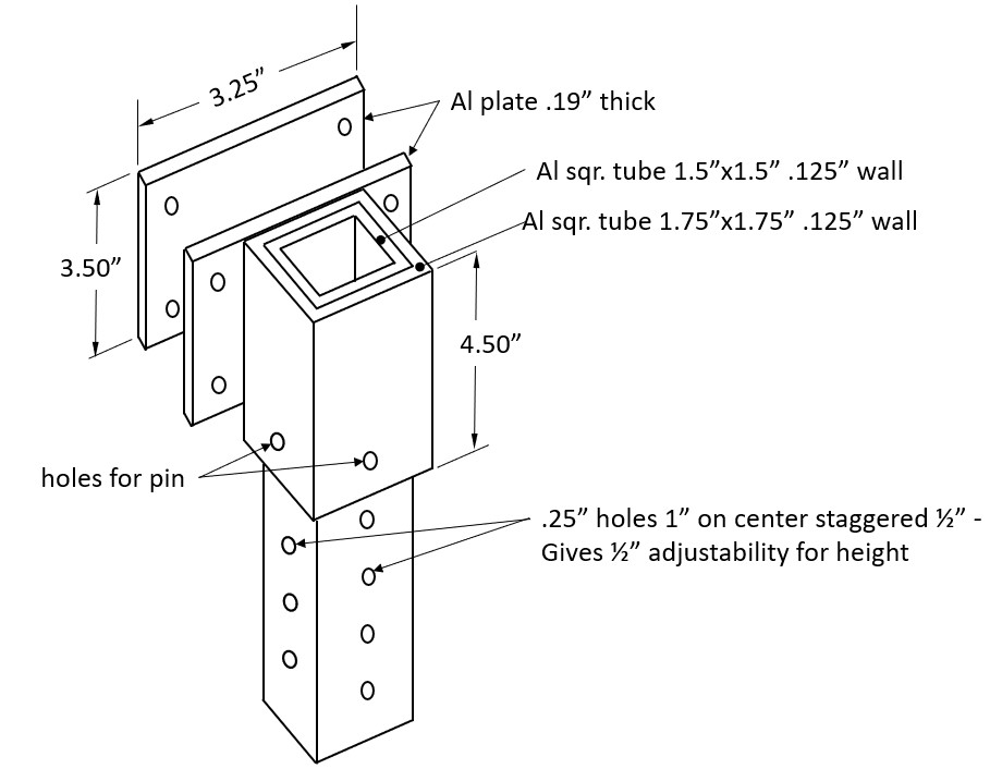

Trailer jack comments – I couldn’t find one that fit quite right, and none of them were particularly light weight since they were mostly designed for 1500-2000 lb rather than a sub 300 lb teardrop. Keep in mind the wheels and tires were nearly a 1/3 of the total trailer weight! In rel life we used the total weight in all the calculations whereas the weight of the tires and most of the torsion axle weight goes directly into the ground and is not borne by the trailer (or tongue); so, in the end, most of the calculations are pretty conservative) - especially the over-the-road calculations. The sketch of the lightweight aluminum jack follows:
Lightweight trailer jack sketch.jpg (72.18 KiB) Viewed 2290 times
Trailer jack BOM with weights
(2) 3.5”x3.25” .19 Al plate - .43 lb
(1) 4.5” 1.75” sqr. Tube .125” wall - .36 lb
(4) 2” ¼-20 bolts with nuts and washers - .1 lb
(1) 12” 1.5” sqr. Tube .125” wall - .81 lb
(1) ¼”x2” L-handle ball lock pin - .2 lb
(1) 3” locking swivel wheel caster
(1) 1" 1.25"x1.25" solid Al sqr. stock - .16 lb
Weight total for jack
3.16 lb
Trailer total with jack:
64.46 lb w/ FR-425-1-S, 66.46 lb w/ FR-425-2-S

twisted lines wrote:I will try and weigh mine. 1000 K lb
That's actually a bit over a pound less than Flexiride listed on their site so that's good to know -- is that for the 4-4" wheel bolt pattern?
Postby twisted lines » Thu May 04, 2023 11:02 am
5 on 4.5 X 2
twisted lines
Posts: 1243
Location: Jefferson
Postby kennyrayandersen » Thu May 04, 2023 11:36 am
twisted lines wrote:5 on 4.5 X 2
Interesting -- that would be the 2-S which they list as a couple of lb heavier than the 4-4" version (1-S) they make another non-adjustable version that is lighter -- is your arm adjustable? How long ago did you buy it?
Postby twisted lines » Fri May 05, 2023 8:54 am
Non adjustable,
Had them about a year.
twisted lines
Posts: 1243
Location: Jefferson
Postby kennyrayandersen » Fri May 05, 2023 1:12 pm
twisted lines wrote:Non adjustable,
Well, that explains that! I've only seen the adjustable ones for sale so far, and those are a couple pounds heavier! Having said that I think the weight is already pretty low so far!
