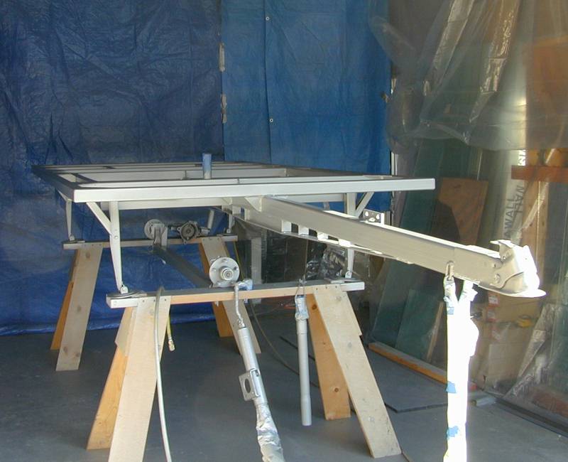

Chris C wrote:My trailer tongue is 2x3x14ga and the A-frame is 2" anglex14ga. Right now the tongue is 51".....but that is without coupler.
Sheesh - in every group, there is always one........ :fb
OK, I've now modified the charts to include 14g tubes, but you'll need to go to the web page to see all the possible sections. Your frame design is a perfect example of what I've called a 'composite tongue', so the strength has to be checked in three places.
I would add 2" to the bare tube lengths to get the approximate length to the centre of the hitch ball.
I can't find 2" x 2" x 14g (0.083") angle listed anywhere as an available size, so I'm guessing that yours are really 2" x 2" x 1/8" (0.120").
So let's use this as another worked example (you need to measure the L1 dimensions and correct the first two parts):
1) Vertical strength of single tongue.
Vertical capacity (from web page table) = 20600 lb-in
Length L1 = 18 in (to be checked)
Max trailer weight = 20600 / 18 / 0.5 = 2290 lb
2) Horizontal strength of single tongue.
Horizontal capacity (from web page table) = 16500 lb-in
Max trailer weight = 16500 / 18 / 0.5 = 1830 lb
3) Vertical strength of complete tongue
Vertical capacity of single tongue = 20600 lb-in
Vertical capacity of each angled brace = 3400 lb-in
Vertical capacity of complete tongue = 20600 + 3400 + 3400 = 27400 lb-in
Length L2 = 51 (tube) + 2 (coupler) = 53 in
Max trailer weight = 27400 / 53 / 0.5 = 1030 lb
The last max weight, 1030 lb, is the lowest, so that's the maximum trailer weight that passes the Aussie rule.
Paul will have to eat his 'Mack' comment - because those tubes are pretty thin, the total strength isn't that high.
So I'd say you have a sturdy, but not overbuilt, trailer chassis.

On the web page I've shown the longitudinal strength of the sections and two 2" x 2" x 1/8" angles do indeed have a strength around 10,000 lb - this is in compression (ie, when braking, or crashing!) - in tension their strength is more like 27,000lb.
I'm presuming the part where you said "....would have 125lb tongue weight. So, it would only need to take about 250lb....." means you think the maximum acceleration of the hitch is around 2g. This is what the Aussie rules provide for, if the trailer has a 25% hitch weight - which is good, as I think quite a few of the teardrops shown on this forum have this sort of hitch weight percentage.
I presume you use 3/16" thick angle on the Camp-Inn as 1/8" angle only achieves about a 1.5g rating on a 125lb hitch weight.
The one item I don't agree on is the "built-in flex" argument - when I was a structural engineer, I heard that theory almost weekly and it is wrong in the vast majority of cases - even when accompanied by the "trees don't fall down because they can flex" analogy, that many people consider is 'proof' of its truth!
Andrew
Postby angib » Tue Apr 11, 2006 6:57 am
bledsoe3 wrote:Andrew, You and the Aussie's forgot one
Yes, but......
Interestingly the Aussies require a horizontal strength of the drawbar/tongue that's the same as the vertical strength. That does seem excessive to me, but maybe they've got a reason for it.
So that reinforcement under Dean's tongue does pretty much nothing for the horizontal strength and that looks to me like a 2" (wide) x 3" (high) tongue, so it would have failed the horizontal test before the vertical test before it was stiffened.
Incidentally, if that's a 2" x 1/8" strap positioned 3" under a 2" x 3" x 11g tube (measured by Mark 1 eyeball), it increases the vertical strength by about 70% - if it's a 2" x 1/4" strap and it's 3" down, it triples the tube's vertical strength.
Andrew

Postby Chris C » Tue Apr 11, 2006 8:06 am
Andrew
Sorry to have been the "there's always one" ! But thanks for walking me through it. I couldn't figure out how to get there. Your last sentence is exactly what I like to hear and exactly what I was trying to build. Thanks for taking the time, Andrew.
Chris :D

Postby Cary Winch » Tue Apr 11, 2006 9:15 am
Andrew,
Hey nice catch on the tensile vs compressive flip flop, I was only doing that in my head. We do use 1/8" angle on our frames. Keep in mind they are only 3 footers. On our longer 560 series we add more structure accordingly.
The flexible member is in the body, not the frame. I too am not big on the idea of flexing the frame. It works as a shock absorber to reduce the shock load to the frame.
I do still need to point out that people need to realize that the load this chart calculates is the weight at the joint of the tongue to the rest of the frame not the total weight of the trailer. I think this is still being misunderstood here in the case of a teardrop application. My example I was using was showing how it is correct for this case. To further show what I mean figure that someone where to strap 500lb of lead weight on top of the axle. Then assume that the tongue weight was not increasing accordingly for safe towing. This would have no affect on these calculations. This is an example of why I say this chart does not correctly give you the max weights on a fixed weight location trailer like a teardrop.
Cary
