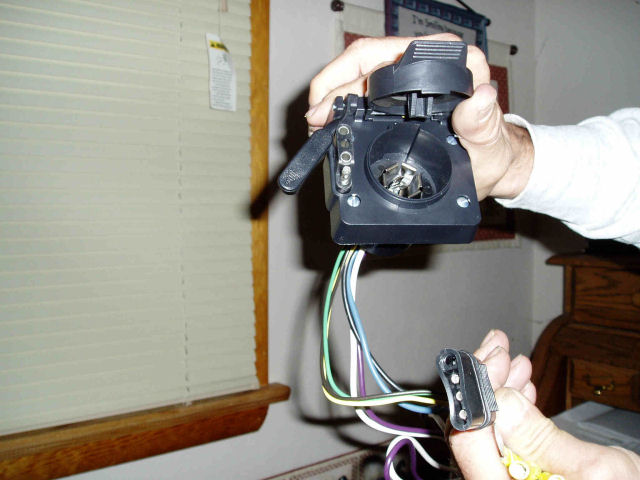

Use one of these on the tow vehicle, the flat plug in the lower right hooks to the present flat plug on the vehicle, now you have both a 7 and 4 prong on the vehicle. The other 3 wires are available to hook up brakes, DC power, whatever you want for the 7 prong. It is mfgd. by Hoppy.
