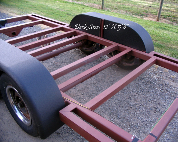

Well, just so you all know, i'm the guy building just such a critter, The frame is done, and waiting for the remainder of the construction to continue.
All of your speculation seems to be right on the money! I did have to build the frame to be more stout due to the double axle. It will cost me more to register it at DMV. It will be larger then what most people here on the board are building, But I have read of people who plan larger trailers. And it sure will tow well.
I'm loving the creative process of building what I have come to call "the longhaul"
But, should any of you out there be foolish enough to build a tandem axle teardrop, Be ready for major ribbing from those participating on this board. When I mentioned it a couple months ago, Finn took off on a tangent -- "finally a place for the hot tub" Well, let me tell you, the frame is large enough for any hot tub, and strong enough too.

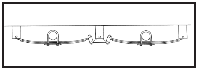

OK, so where's the pics of this monstrosity? I see one shot of a couple of axles and a drawing. You'll never survive around here if'n ya cain't do better'n nat! 8) :lol: 8) :lol:
What's the specs on it... no numbers on the drawing? :thinking:

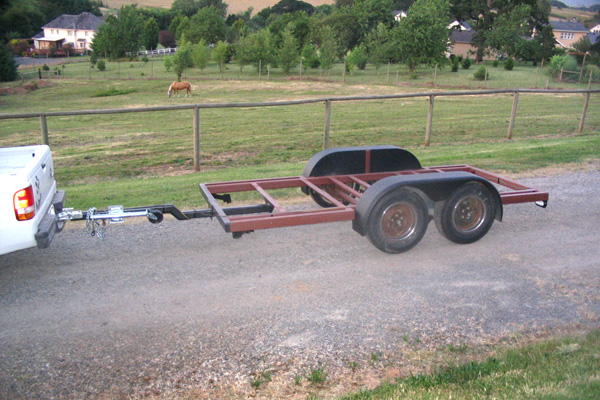

Postby jdarkoregon » Wed Jun 28, 2006 3:00 pm
Sorry it took so long, I'm going crazy with all the little projects I am having to do, Anyway,
The reason this frame is soooooo Stout, is that my welder (my brother-in-law) is a professional welder who builds Cell Towers, Everything he builds can go through a Level 5 Hurricane, AND the metal was almost FREE. There are several Cross bars, as I expect to put in several Under Floor Storage areas and a footwell,
The deck size is 12 feet by 5'8" and the shape of the final trailer with be that of a modernistic but the interior height will only be 48 inches
Thanks for taking the time to make a comment, Ribbing will be expected!

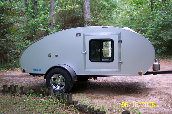

Postby Sonetpro » Wed Jun 28, 2006 3:52 pm
Mine is 143" X 60"

Postby jdarkoregon » Wed Jun 28, 2006 5:12 pm
SonetPro, how much overhang do you have on the front and the back, I have loved watching your build, and your first beach pictures were beautiful, Exactly what is going on with the siding surface, What is the siding?
Mike, Thanks for the Go Ahead, your comment on length helping the design is exactly how I was thinking, Then it won't look like a bubble.

Postby Sonetpro » Wed Jun 28, 2006 5:26 pm
My floor is 10' I have a 12" overhang both front and back. Wall height is 48"The siding is clear anodized sheet from SAF. Not as shiny as mill but will always look like that. I didn't want to use mill because it was made to beach camp.
With the mill and salt spray it would have been a maintenance nightmare.
