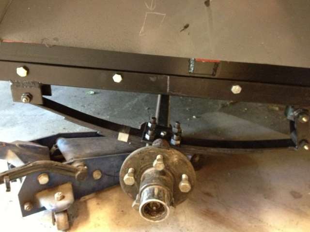

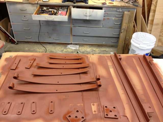

Well today I was able to finish up the leaf spring swap. At first the rear bracket was place so that the shackles where straight down to the leaf spring. When said and done I moved them toward the front by an inch. So I set up the suspension three different times and put weight on the springs. Ended up with about a 30 degree angle on the shackles. After that burned everything in and primed it all.
Painted it with Rust-o-leum industrial black. I like that stuff seems real tuff. So today I assembled everything. Took axle grease and applied generous amounts to the springs and bolted them together. Took and pressed the new shackle bolts into the new shackles. And installed the bronze bushings. Pre greased all the bolts and put it together. Ended up having to place the axle on top of the springs because if the shallower spring set. Used four 1/2" bolts the anchor the angle to the frame. Here it is all set up ready for tires.
Took it out in the road and let me tell you. It is worth replacing and up grading to the greased wet bolts and taking your time with the springs replacing the bushings and painting them. It is money well spent. I feel more at ease taking it on the road now. It did end up setting about 2" higher but I like the way it looks. Plus with lowering the the front coupler it helps the ride height.
