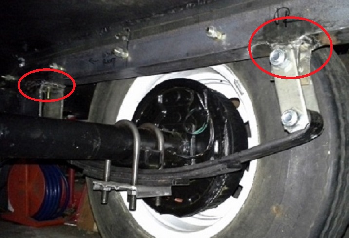

It's probably too late to help, but I've been away from here for far too long to respond sooner. There are pictures of how I reinforced the side C-channel of my NT frame when I attached a torsion axle to it at http://www.tnttt.com/viewtopic.php?p=945851#p945851 . I need to warn you that my trailer isn't finished yet, so this reinforcement hasn't been road-tested. But it was a simple modification.

Postby absolutsnwbrdr » Fri Jun 20, 2014 1:28 pm
Good idea! I'll check on my frame at the end of this season and see how its holding up. With the axle assembly acting as a rigid cross-member I wouldn't imagine that the extra reinforcing is necessary, but it certainly won't hurt. I think that the individual stock leaf spring mounting brackets would create much greater stress points compared to the torsion axles mounting brackets.

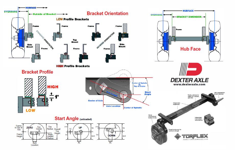

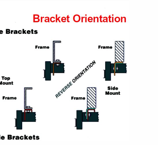

Postby angib » Sat Jun 21, 2014 6:31 am
If you are custom-ordering a Dexter torsion axle, the Dexter diagram below (with enlargement) suggest that the axle can be ordered with 'reverse orientation' mounting brackets that would put the vertical leg of the mounting bracket in line with the vertical leg of the trailer frame, in which case I don't see the need to add any reinforcement.

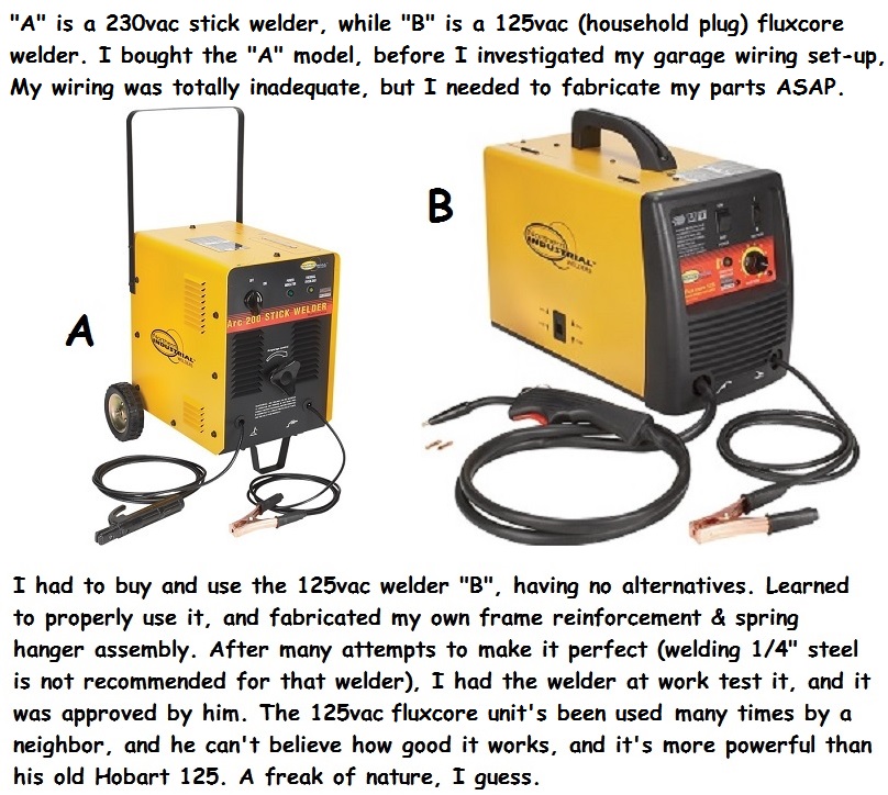

Postby working on it » Thu Feb 15, 2018 6:17 pm
tony.latham wrote:I think it might scare some folks on how easy it is to learn to weld. I spent three nights in a community welding class, bought a refurbished Hobart wire-feed and haven't looked back.
  • After watching expert welder/fabricators for years, while at work or at friends' hot-rod shops, I had never actually trained. nor done a welding project on my own. Though I had tried a little welding with a friend's 220vac Miller mig, a couple of tries with a 220vac Lincoln stick welder at work (and a couple of passes using a Tig), I had never used one for a completed piece of work. My access to welders at work was now past, as was my access to the hot-rod shops I had been using, so when I was faced with replacing my TTT's axle, and reinforcing/repairing a torn frame, I had no welder to use.
  • I went to Northern Tool, and bought their 220vac stick welder (Northern Industrial Arc 200), which I wanted to do 1/4" steel frame work, before I ever investigated the garage wiring. Like everything else the previous owner/builder of my now-defunct house had installed or touched, it was totally wrong, and not nearly adequate for that welder. I have just now replaced that wiring with the correct stuff, from house to garage, during my new house project. So now, once I empty the stored furniture from the garage, I'll be ready to stick weld. But, at that time, after seeing how much it would cost to completely re-do our total house/garage wiring, I opted to try the household current 125vac welder Northern had.
  • I hadn't tried a fluxcore welder but once, for a single bead, before I bought it. I tried welding a "redneck engineering" temporary front towbar device as practice, prior to beginning my axle replacement/ frame reinforcement project, but it looked very bad (though it worked fine) . I had tried welding a chromed hitch ball to mild steel, which I found out is difficult. Nevertheless, against the consensus of many forum members, I launched into my project. I completed my welds, finally, and took my finished assemblies to work, where I had our welding expert inspect and test them for flaws. He found none, and was very impressed when I told him that I used a 125vac fluxcore unit. My neighbor has had the same impression from using it, several times. But still, I intend to retouch my work, 4 years and many miles later, with the big stick welder.
  • Necessity is the mother of invention - when the need for something becomes essential, you are forced to find ways of getting or achieving it. I had to make the fluxcore welder work, and trained myself to do so (with a little luck, and a fail-safe [bolt-on + weld-on] mounting scheme). I've done very little welding since then, as my fluxcore spends a lot of time on my neighbor's projects, so as soon as my garage is cleared and ready, then I can use the big boy 220vac welder (assuming I can still crawl under my trailer, by that time...I'm old and worn out!).
    my Northern welders.jpg (214.38 KiB) Viewed 19695 times
    if the big "stick" welder works as great as the little "fluxcore", then I'll be very pleased!
