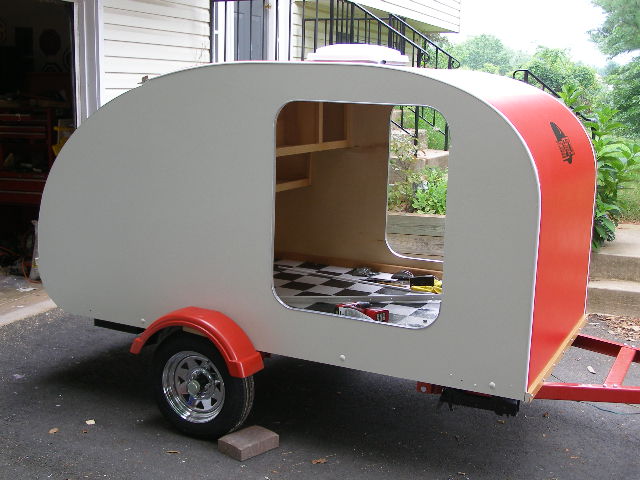

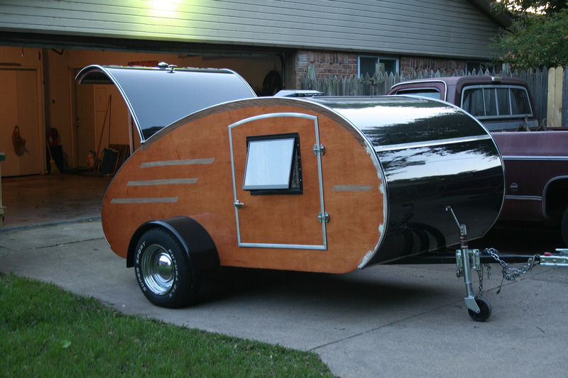

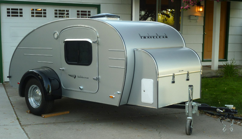

A couple of photos to illustrate my concerns. I think this first one looks like the tyres are too small. 12" x 5.3" Not sure of the actual size like we use.
The next one has tyres 205/70/R14
Tyres 1.jpg (138.78 KiB) Viewed 329 times
And finally the tyres from one of my favourite threads. I think David said they were 205/75R14
The bigger mudguards also help but I am going to put on the mudguards the same style as the second photo using the same methodology as he did. Will show in next post as only allowed 3 attachments

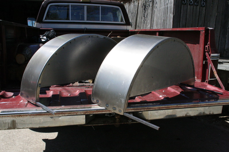

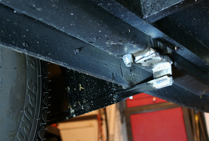

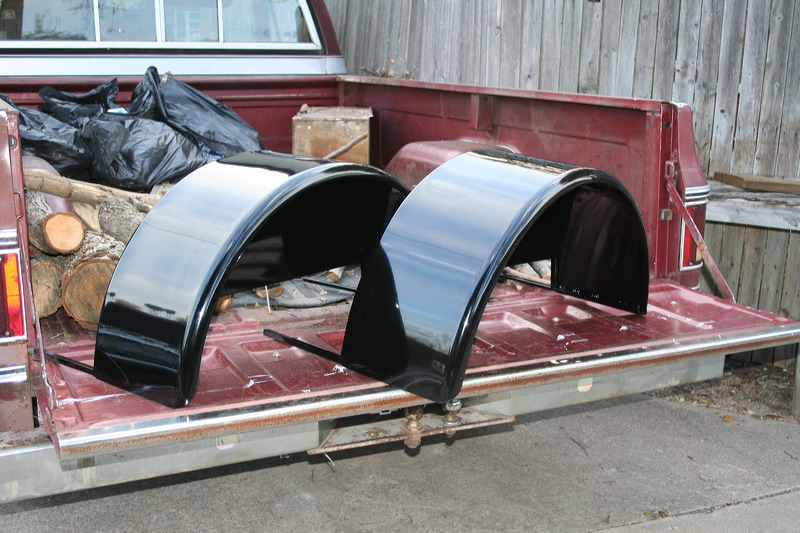

Mudguard design and attachment method planned.
Mudguards 1.jpg (135.6 KiB) Viewed 328 times
Mudguards 2.jpg (169.71 KiB) Viewed 328 times
Mudguards 3.jpg (126.86 KiB) Viewed 328 times
Just need to place some felting between mudguard and body. I am thinking the welding should keep them in place. The only problem would be is someone sat on them so maybe a light on the top to stop people thinking about that.

Good to see some detailed planning going on there. My wife is 5'3". My Mum was 5'2.5' and she always made sure to claim the extra 1/2". You can get your bench at an easier reaching distance by curling the back under a bit and there by bringing the bench back nearer to the floor length.
I can see that the Citroen would not be easy to match up with, that is 2mm under a lot of Japanese stud patterns.
I have 50x50x3 frame and a torsion axle. The axle centre line is about 1/2" below the bottom of the frame with the TD sitting at rest. The axle we bought had a stud pattern to suit Falcon or Hi Lux. We went with the 14" Hi Lux because a guy in town here had a pair for sale on Trade Me for $20, and I have 195/60R14 tyres on them as I had some in the shed left from my tyre shop days. I just went over to the shed and put a tape over them, to give you a comparison, diameter measured horizontally 22.5". The distance from the centre of the axle to the ground is 11" and the frame is 11.5" from the ground. I assume that when you were working the calculations for your bench height that you worked on half the difference of the diameter of the tyres?
I have guards very similar to the ones you are looking at. They don't have the inner guard piece like those ones have and I haven't as yet seen the need for them. To mount them I welded a length of 40x5mm flat bar on its edge to the bottom of the frame with a couple of m6 bolts set well apart. The guards sit only about a couple of mill off the walls and don't vibrate enough to touch them. Also they are strong enough for me to stand on top of them when I am washing it.
