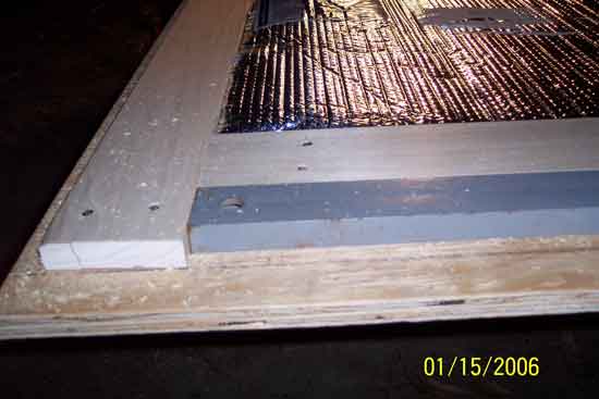

Another question has arisen .... my cabin fits on the trailer like the trailer for two ..Mi '47... in that the front frame is bolted on to the front V of the trailer, essentially leaving the front/frame/floor unsupported at the ends... should I weld in an 2x2 angle iron support for the front frame member ??? am I worrying too much ???
Postby Sonetpro » Sat Mar 11, 2006 8:37 am
GPW wrote:Another question has arisen .... my cabin fits on the trailer like the trailer for two ..Mi '47... in that the front frame is bolted on to the front V of the trailer, essentially leaving the front/frame/floor unsupported at the ends... should I weld in an 2x2 angle iron support for the front frame member ??? am I worrying too much ???
Here's what I did. I'm also using a boat trailer. I embedded a 3x1 1/4" C channel in the floor. Routed the grooves for the legs to nest in. When I mounted the floor I drilled though the wood and C channel and bolted it to the V of the frame.

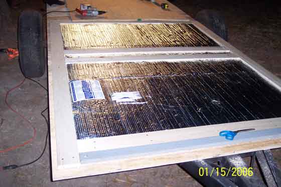

Postby Sonetpro » Sat Mar 11, 2006 8:41 am
Another pic.
