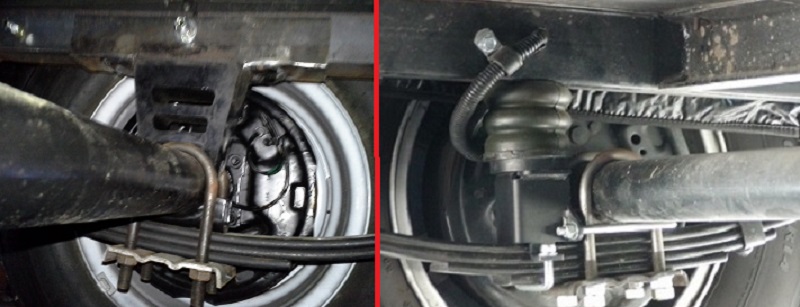

* My 25.25" long leaf springs (3000 lb set, on a 3500 lb axle) only droop <1.5" when the trailer is lifted off the ground, preventing use of "long-travel" shocks of any sort, but there is a need for bump stop protection from bottoming out (or worse, stressing leaves and shackles by flattening out on severe bumps).
* Sumo Trailer Helper Springs ($215 @Etrailer), as used by gudmund and tony.latham, or Timbren Active Off-Road Bumpstops ($225 @Etrailer) would've done the job for most trailers, but the small amount of travel in my suspension required a custom solution. I didn't want to cut down Sumo's to fit, and I was unaware that Timbren had that product, which would've needed modifications to fit, anyway). Thus, I fabricated my own, from Daystar polyurethane "progressive" bumpstops ($60@Amazon) and $7 worth of 2"x 2" x 1/4" steel angle. If it hadn't worked as I envisioned, then I only would be out a fraction of the cost of the others.
* To fabricate http://www.tnttt.com/viewtopic.php?f=35&t=59570, I cut-off the hard cap atop the bump stops, used a holesaw to scoop out a recess to form-fit the 2.375" axle, and welded the bumpstops to the 18" long pieces of angle iron, so I could bolt them to the newly-reinforced frame just above the axle. It was a snug fit, and felt quite firm, with no movement noticeable when back on the ground. If I ever detected a harsh ride on the road, I could still soften it up by cutting a cross-linked filament. After several years of use, there's been no need to do so. I suppose any harshness is absorbed by the "flotation"-type LT tires I use (27 x 8.5-14LT General Grabber AT2).

and yes to "working on it" as you may have noticed in the posted picture I attached, yes I did end up cutting one inch off of the 'Sumo' 4 inch tall rubber spring. (its now 3 inches tall with a 1/4 inch of preload per instructions) ..........................

gudmund wrote:and yes to "working on it" as you may have noticed in the posted picture I attached, yes I did end up cutting one inch off of the 'Sumo' 4 inch tall rubber spring. (its now 3 inches tall with a 1/4 inch of preload per instructions) ..........................
homemade active suspension... modified Daystar vs modified Sumo.jpg (87.75 KiB) Viewed 4641 times
* My Daystar piece is about 1.25" shorter than it was originally, now about the same height as your Sumo, and with about 0.5" of preload, after being moved into place with a BFH (there were no instructions as I was using the product in an entirely different manner than intended). Both systems stay in close contact with frame and axle/spring assemblies (your Sumo is attached to the sprig, whereas mine is attached to the frame), and the progressive compression nature of each removes the danger of instantaneous/complete bottoming-out, that bumpstops alone (sans shock absorbers) would provide. It's a way to help out out our trailers with insufficient axle travel to utilize true shock absorbers.

I can live with that - nice comparison photo set and explanation. :thumbsup:
