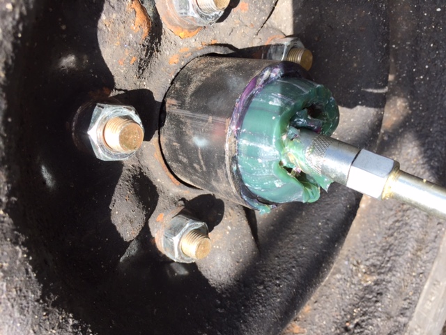

Postby swoody126 » Mon Feb 08, 2021 8:17 am
i've used both styles of Dexters and since the torsions were on a tandem boat trailer i don't think my experiences compair to what tnttt builders experience
their leaf spring units have dunn a really nice job of caring for my wooden skiff and have caused no issues under my 6x12 enclosed utility
what i really like about all the Dexters i have used is the way they can be serviced ... thru the dust cap
at the beginning of each "season" and prior to any long/extended adventures i jack each wheel off the ground and spin it listening for any growling or even light ruffness and check for looseness of the bearings
when i hear no noises i simply remove the rubber plug in the end of the dust cap and add fresh grease until it oozes clean grease around the spindle nut
if i hear any "off" noises i pull the hub and address the whole assembly
i use blue-green "marine/agricultural" grease i get from Tractor Supply in all my grease guns(agricutural marine and utility) and have had zero bearing issues on the road
the Dexter spindles have the zerk fittings on the outer tip w/ a passageway thru them to a point between the inner seal and inner bearing
when new grease is introduced into the zerk it goes to the inner most point in the sealed hub and forces the older grease outward THRU the inner bearings > thru the hub cavity > thru the outer bearings > then out around the spindle nut and clearly visible to the nekkid eye
here are pics of this process on a new boat trailer axle(repacing an axle that was used to begin with and had been on that boat trailer for 26 years)
the axle was shipped w/ red grease(not marine)
stock grease coming out.jpg (140.31 KiB) Viewed 1870 times

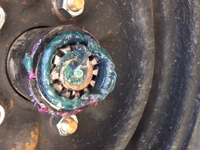

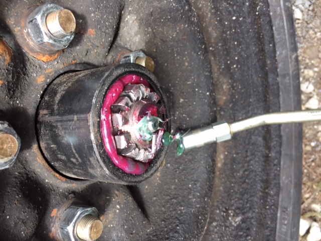

red grease going away w/ new blue grease taking over
green grease coming thru.jpg (131.61 KiB) Viewed 1870 times
no more red

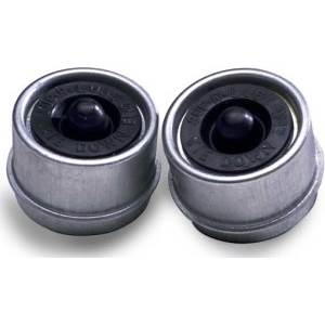

the rubber plug dust caps don't always get shipped on the axles so i buy them at the local auto parts store and install them so future servicing can be done by simply pulling the plug providing access to the zerk

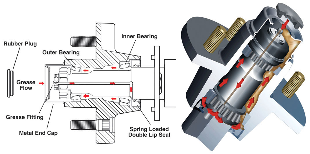

here is a chart of how it works
i hope your Dexters use this system
if you are still in the buying stages try your best to insure this system is included in your new purchase
it makes trailer life/maintenance so much easier
sw

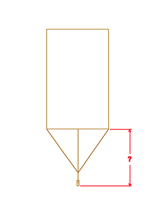

Is there a rule of thumb how far the distance should be between hitch receiver and the first cross member on the chassis?

Postby swoody126 » Sat Feb 13, 2021 8:50 am
Capebuild, the longitudinal dimension you indicated IMHO is knot as important as the diagonal distance between the to points
i design my trailer tongues so i can not crash into the cargo body w/ the corner of the bumper of the widest tow vehicle intended for pulling that trailer
this means the distance would be different for a trailer being designed for towing behind the Jeep than for one being designed to follow the F-350
this issue can involve both TV and tnttt body damage when towing w/ the Jeep
this issue would result in destruction of the tnttt if the reinforced steel RanchHand bumper on the F-350 hit the little trailer
this question brings up one more important measurement...
the distance from the ball hitch to the tongue jack stand AND the style of jack being employed
if the jack is one that is to be welded/bolted in a vertical manner to the tongue it needs to be far enuff back from the ball hitch for the tailgate on the TV to function as designed
i have seen too many pick-up tailgates w/ a dimple in them where the gate fell on top of the jack
i have seen many SUV's that couldn't open the tailgate for accessing the cargo area while hooked up/traveling because the tongue jack was too close
swing up jacks resolve this issue most of the time
if this presents a problem in storage in your garage do the slide in tongue trick using a hitch receiver for the tongue frame that accepts a stinger which can be removed for storage a/o security while being left unattended

something to remember is - it is easier to back-up a longer tongued trailer than a shorter one (along with just having more room on a longer tongue set-up for more stuff to be mounted+++) My first trailer was a 4x8 tear with a 4.5ft long tongue - the one I have now is a 5x8 with a 4ft tongue = didn't think 6 inches length difference would make much of a difference -BUT- oh yes it did!!! When backing them, the "longer" one backed up "so much easier!! The shorter one is ok, "but" I find I just have to back-up 'just a bit slower' - watching 'just s bit more!!' than before................ go longer if you can....
