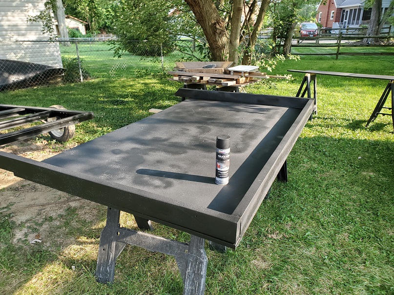

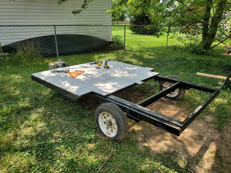

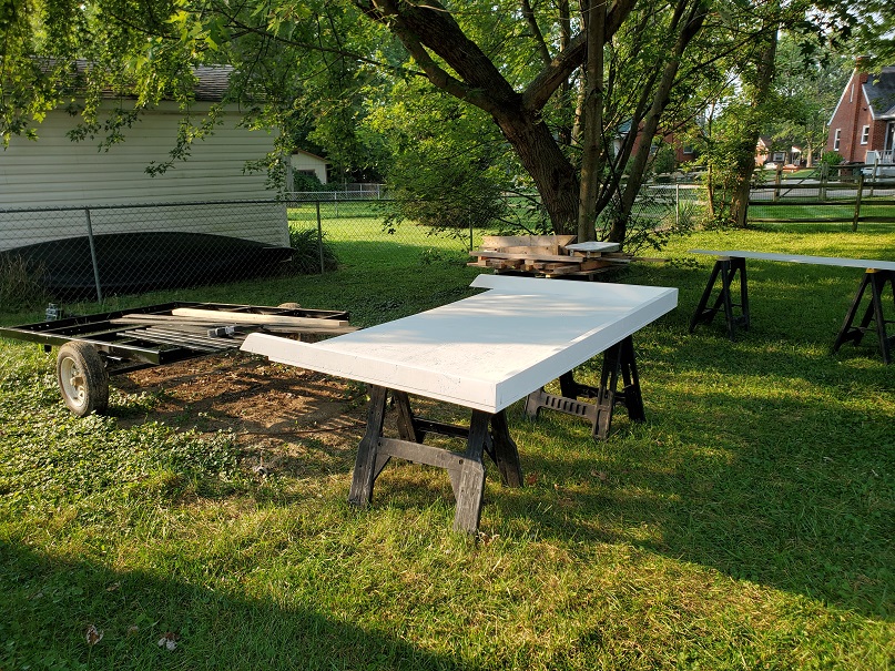

TheOtherSean wrote: The floor is 3/4" ply that overhangs about 9" in each direction, and is reinforced underneath the perimeter by 2x4's. It is just barely campable at this point, and I have towed it about 3000 miles. It seems fine so far.
Can you share some pictures of this?
Sure. This is what the front portion looked like while painting and during installation. I hope you find this useful.
Front floor section upside down during priming:
Front floor section primed, upside down
Front floor section upside down during lining:
Front floor section lined, upside down
Front and middle floor sections during installation:
Installation of front and mid floor sections
