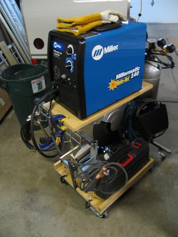

Here is what my rig ended up as, did not particularly like ready made carts (wheels way to small) and besides its tradition the your first welding project is cart for welder.... Upgrade to cart has been tool box that sits in lower shelf that holds a few tools (wire cutters and gloves and ...) also spare roll of flux core and roll of solid wire... Always have spare roll of wire handy because you will run out at worse times...

Postby bdosborn » Sun Nov 24, 2013 11:22 am
Dale M. wrote: Here is what my rig ended up as, did not particularly like ready made carts (wheels way to small) and besides its tradition the your first welding project is cart for welder....
I did the same thing, only with a blue one:
I should used bigger castors though, PITA to roll around the garage....

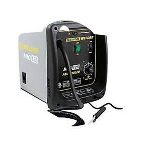

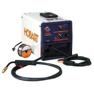

How often do you guys use your welders? I can't see using mine very much; just for trailer mods on the current one, modding/repairing my idle car-hauler, and perhaps the second trailer I wish to build. Probably not very much, at least until I retire. Just experimenting until I get OK at it. I still will use/trust bolts mostly, as that's what I'm used to! So would the Hobart 125 be good enough? or at least cost effective for me now (with 220v also available, should I plan on a stick welder for heavy metal later)? I'll admit that I've been looking at both the Jobsmart 125 at Tractor Supply and the Northern Industrial 125 at Northern Tool lately...as a learning tool, and though probably not as durable as a Hobart, might be good enough at the price for tinkering. And the warranty is only 90 days at TSC, longer-at a price-at NT, not too good, instead of the 5/3/1 Hobart warranty. (Wait! I think that might convince the wife!) I think I'm leaning towards the H125. Only one question more: at 3/16" max thickness per pass (with flux core), can a second or third pass improve the penetration to use on 3/8"steel? I will probably never weld thicker than that (3/16" is as thick as I normally "drill-cut-saw-bend-bolt" presently)?

working on it wrote:How often do you guys use your welders?
My first welder was bought to allow me to make bumpers, a tire carrier and various skid armor for a Jeep XJ. It paid for itself with that project; similar to buying a welder to make a trailer frame. Use after that has been sporadic with maybe a year going by with no use. But it has been super handy for repairing a couple of chairs, repairing a property gate a tree fell on and then a couple years later making a new gate when another windstorm blew another tree onto the gate. At home in the last month I made two frames for new gates for the side yard parking area; 1x1 steel tube with metal roofing panels screwed on; matches the home roof. Made HD hinges for the new steel posts. Better then any wood framed gates, better than store bought as they are a weird size. I have made repairs to the utility box trailer (31 years old and counting) a few times. Some garden tool repairs come to mind; saved buying a new hoe and a new rake. Made a steel tube teeter totter for the kids. Jeep top "luggage" rack. Repaired cracks in wheelbarrow tray. And there is lots of small stuff I can't recall off hand.
Re: accessories. Welding helmet. Absolutely buy a auto darken model! With a variable darkness is nice. I have one 15 years old and love every minute I have used it. Change the front protective cover when it gets cruddy. Test it with a "sparker" before every session.
Gloves are a must and a jacket or something is necessary to cover the arms. Electric welding w/o gloves and arm cover will give you sunburn. There is lots of UV in the electric arc. Bad sunburn if the project is big enough.
Other accessories for me include a chop saw or a bandsaw for cutting. Chip hammer for flux core wire. A couple of grinders; I like two as sometimes I like the nicely worn in curve on the old grinding disk, sometimes I want a more squared edge. That's probably just me.
Spare wire on hand is very good to have. The spool is hidden in the machine and often I am surprised when it runs out. I could check more often but don't.
A personal luxury is owning two C25 cylinders. That way I can get one refilled when I'm going past or near the welding store on some other errand rather than be forced to make a special run.

Postby MtnDon » Sun Nov 24, 2013 2:49 pm
Quality is equal to their 140, IMO. So yes, okay for hobby welding.
If you find you need to weld something thicker you need to bevel grind both materials to be welded. Then weld in the bottom of the vee. Then work up the vee with another bead; a side to side, back and forth pattern allows filling in a second pass depending on thickness. I find that for my welding I seldom ever use 3/16" steel, let alone anything heavier, but that will vary from person to person. Mostly I find myself using 18, 16, 14 or 11 gauge mostly.
Link to gauge # = inches
I think the last 3/16" I used was the original jeeps bumpers. Man they were heavy. Generation 2 were 1/8" (11 ga) and served just as well though I did get a few small slight dents.
