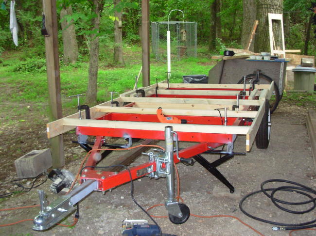

I modified the tongue on my HF 1720 (box said 1800# when I bought it in 2006) to add several inches to its length (for building a 114" cabin on the 4x8 chassis). Also mounted a 'swing away' tongue jack w/wheel which I've used ever since. The current height of my coupler (inside) is approx 17". Without the tongue mod it would be approx 2 1/2" higher or 19 1/2". My tires are 530x12 & I have added a 1" 'lift block' between the axle & the springs. Height from ground to top of chassis is approx 20 1/4" since the chassis rails are 3" high & sit on top of the tongue 'A' frame. I think the height of 23" would be to the top of the fenders as they extend about 3" above the chassis when installed (I didn't use 'em). I do have BAL type stabilizers one all 4 corners of the TD so the tongue jack isn't required to support much 'static' weight (which I think it would do easily, it has 800# rating) but I've used it to re-position the TD numerous times on dirt, gravel, & paved surfaces, with no problems. Once I failed to complete my pre-departure 'checklist' & towed the TD approx a mile (slowly) with the tongue jack in down position and wheel only partially retracted. Couldn't figure out what 'that noise' was as I crossed some 'rough' spots :oops: . Finally stopped, finished raising the wheel, & 'swung' the jack up. No damage except to my pride :thumbsup:
