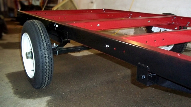

I own both types of HF trailers and there are some differences in addition to the axle.
The cross frame pieces for the 'heavy duty version' are much heavier steel and are a partial box instead of a C channel.
The side pieces also have integrated stake pockets instead of the side mounted stake pockets of the folding trailer.
Also, for some reason, the folding version has a cross bar piece for the front A-frame that is not provided with the heavy version. This seems very weird to me and I plan to provide my own cross brace.
My heavy duty is new and I've owned the folding for many years. For $208, that was a great deal on the folding trailer in my opinion. If your build is under 700-800 lbs, that version should be fine.
However, for the additional $100, I went with the heavy duty version for no other reason than the larger & higher rated tires.

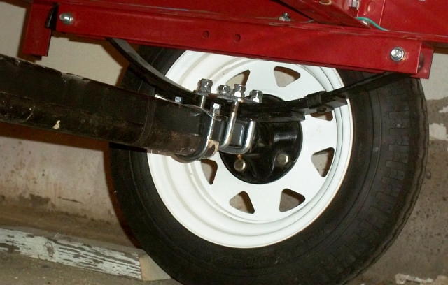

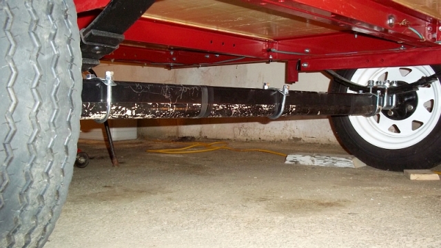

Well, here's what I did, Just found an old piece of metal pipe.
It's hollow, but pretty thick steel. And, it just starts to fit into the opening on the U shape axle of the folding trailer
Just bolted it on with some hardware store U bolts...I'm sure it will add some stiffeness, anyway, I feel better about it now
also...I double nutted the U'bolts that hold the axle in place. Every time I get under there, it seems I can crank on them and tighten a little bit
Guess it's all just wearing in, I've only had it out like 3 times...I see what's rattling or loose, or what appears to be a weak spot than I DIY it where needed.
I'm just re finessing little things on it now...I'm done worrying about it, it is what it is...

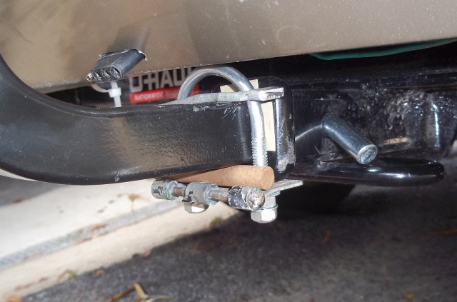

I started a thread a bit ago about the hitch rattle at the receiver..got a lot of good feedback Nothing I couldn't build myselt...So I tightened up hitch at receiver with a U Bolt, a hinge, and a rolled piece of steel and some aluminum shims on the sides. Tight as can be now.

I did something similar. After using the BFH to straighten the bend at the end of the left spindle I used 1" black pipe which barely fits inside the axle. It's bolted and welded into place.
Then I boxed the axle on the bottom with 3/16 plate for about 6" on each end and drilled new spring mount holes. Finally the axle was flipped and installed. I also doubled the nuts on the U bolts.
I'm headed out for about 350 miles this weekend so this will have to do until Northern Tool gets the axle I ordered 3 weeks ago in stock.

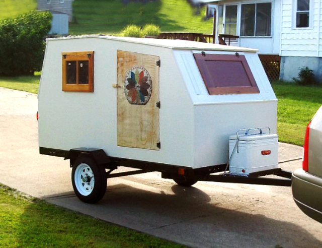

I water tested the Gypsy Wagon yesterday....not bad, since it's really a piece of 'found' art...you know, used whatever I could find to build it.
some leaks around the little windows, I expected that, never weatherstripped them correctly...checking weak spots..so beefing up the weatherstripping here and there, built screens for the hatches,,,, and already thinking about which one to build next...

Yep, I loaded the little trailer up..about 950 lbs fully loaded...and.been running it around, seems to be fine...hubs nice and cool , rides nice, I can feel it pushing the Ford station wagon a bit...but, that's the vehicle I have, so off I go.
Getting the Ford Focus wagon serviced tomorrow, new tires on it... and then heading out from Pa. to Florida soon
Slow ride...for sure
I like the cargo style build I did...I saw a pic of what was called the Nano Weekender on this site and that was the one I wanted to build. It's not the exact weekender, but close.
Of course, I love the original tear shape, but I'm more of a hauler of 'stuff' than a camper, really.
