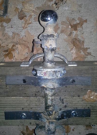

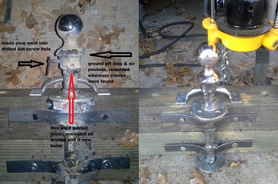

working on it wrote:... so here is a pic of the un-chipped, un-cleaned, un-ground welds on my experimental pushbar:
I'll clean it up and grind it down next weekend, to see if it can be usable. Gonna be a long learning curve.
The saga continues: I had some time left today (after I converted my Craftsman generator's mobile cart-leftover after I mounted the genny in my trailer- to a cart for the Northern 125 Flux Welder), so I got my newly bought 80 grit flapper disc and attached it to my angle grinder, and set to work at the mis-welded experimental pushbar project, again. First note: I love the flapper disc! Never used one before, and I like it better than the grinding disc for removing and smoothing metal (grinder disc jumps around and hard to handle). I took out my BFHagain, and really whacked the assembly hard, in several locations, harder than last weeks test. One weld did break loose, the collar holding the hitch ball in the pipe. So I started grinding (flapping?) the slag and flux and spatter from the piece, then using a wire wheel in my drill to get as much of the rest as clean as I could. I exposed some cracks and seams in the welds (especially around the seat of the chrome ball and the cast iron collar). The chrome/ galvanized /cast iron mix is not an easy weld to make on a first attempt! I had not prepped the various metals correctly, nor had properly beveled the edges, nor gotten the heat and wire feed speeds correct last try. After todays clean-up, I tried less wire feed speed, more heat, less distance, more time on weld. Since I had already burnt off the zinc coating last week, I could get closer to the piece, and could actually see what I was doing. I could gauge the lead of the wire needed (1/2" worked best), the wire feed speed to keep it there (6.5 on my dial), the right heat (on high, and kept in one spot until it glowed red, then moved on). I see that rounded surfaces may be a bit more challenging than straight and flat ones, especially for a novice, but I pressed onward. I re-smoothed the new welds, that were much better than my first attempts, with less spatter and less globs/air pockets to grind away. I also drilled out the screwhole that secured the collar to the pipe previously (in addition to a poor spot weld), and drilled thru into the core of the hitch ball's stem. At this point, after I saw only a couple of points to reweld, I did a deep plugweld into the drilled hole, feeding much wire into the glowing abyss, for a long time. After a break, to let things cool a bit, I used the flapper and wire wheel for the third time today. Not a professional result, nor even a good amateur's, but for a complete noob at this...I was satisfied for an hour+ work. And the BFH didn't dislodge anything this time.
