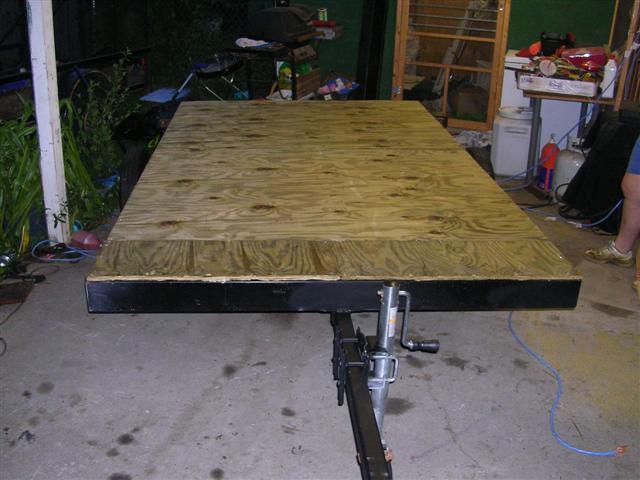

Postby CHUCKLEHEAD69 » Sat Aug 19, 2006 6:41 pm
i budgeted 1800 for the build.right now i have 270 dollars in my build and have a complete trailer except the fenders (got the metal for free)Image
